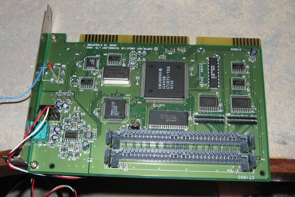

Today I received a CT1920 AWE32 Upgrade card. My second creative ISA card next to a SB-16 Vibra-S CT2800. It is the back half of a normal AWE32, and it does only midi music. I don't have extra memory for it yet. but it has 512kB ROM samples and 512kB RAM on the card.
I have three ways of getting the music signal out of the card.
1 Solder on a 3,5mm Jackplug connector (Analog).
2 Solder on a coax S/PDIF connector.
3 Make a cable for the 2x4pin goldfinch connector (Analog).
Now I did 1 and 2. And I started playing some music with the card. Now the analog gives an obvious interference, I can hear the mouse movement. And the volume is quite low.
S/PDIF then; The interference is gone, the music sounds nice, but I have the volume sliders of S/PDIF input on full, my speakers amplifier is on full too, and then it is just OK. But the other soundcards sounds are now of course dangerously loud. Can this be fixed?

The manual 'wavtabup.pdf' explains the pinout of the goldfinch connector. Fortunately I found a 4 pin connector cable that I could rewire easily. Just tested it and it is the same as with the jackplug output; interference, and the same low volume.
    71.57 KiB
    7910 views
    CT1920 with improvised connectors

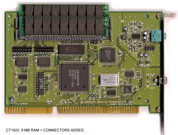

I made a picture of the now complete CT1920 AWE Synth. 8MB Ram is installed and a coax S/PDIF connector was added next to the jackplug I added earlier. It took more effort than I hoped, because the connectors were stubborn not to go all the way in the circuit board. Also they needed adjustment as to put them at the very center (in height) of the metal bracket.
These 30-Pin Dimms sure look primitive. They get very hot when the system is powered, that is probably how it is supposed to be, but I don't like it.
Still this card is a great way of getting the AWE32 music features in a modular form.
    90.76 KiB
    7619 views
    CT1920 Modified

Reply 12 of 15, by gerwin
The analog circuitry of this card is on an analog 'island' on the PCB, which has a different ground plain. On the picture that is on the top right. You can see there is one small chip bridging over to this area, which should be a DAC (8 legs). Then between the DAC and the Jackplug is another chip with 14 legs. But I don't know what it is for.
About the soldering. In this case I suppose it is mostly about having a reasonable soldering set plus a drill, and about preparation for fitting the connectors. The actual soldering is done pretty quickly.
I suppose it could handle the usual AWE maximum of RAM. but I don't have any 30-pin 16MB sticks myself.
