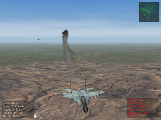

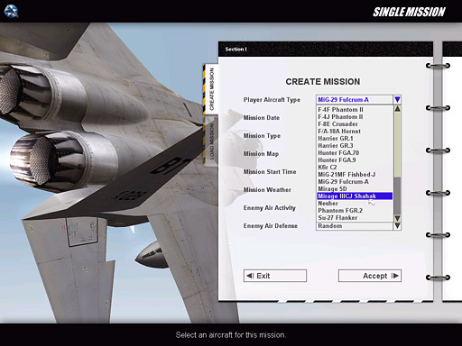

Hi there fellas. I've been waiting for years to get my hands on a decent combat flight sim and with the release of Hawx, all my hopes are lost.
Have you tried Wings over Vietnam/Europe/Israel Link ?
All games may seem a little plain on themselves, but you can manually merge them into one big combat flightsim (Fighters anthology style) if you want. It covers 1960 to 1985 air combat very well.
