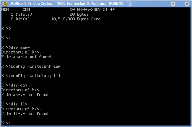

I'm running 64-bit OpenSuSE 11.1 on an Asus M2N4-SLI with AMD 3500 CPU, 8 Gig of RAM and several TB of disk space. I installed both DOSbox and the dosemu from the OpenSuSE repository. I need to be able to edit a config file so I can run some very old software to extract historical expense data from something written with DataBoss in the early 1990s.
Attached is a jpg showing what I'm doing and the results I get. Yes, I've read the README file after searching for it...not easy to find on Linux.
Perhaps I'm just being dense, but I'm not seeing any output.

    shows execution of config.
Reply 1 of 24, by dougdahl
Config writes a file to whatever directory you started dosbox from. So if you exit dosbox, you should find the files aaa and lll there. (Though it would be a good idea to use dosbox.conf as the config file name. Anything other than that or the file .dosboxrc in your home directory only and while running Linux only, will require you to tell dosbox to look for whatever you call the config file when you start dosbox.)

Reply 3 of 24, by seasoned_geek
While I thank you for your feedback, on this platform at this tmie, it is incorrect:
roland@linux-uz4n:~> cd /
roland@linux-uz4n:/> sudo find -name aaa*.*

config simply isn't generating any output on 64-bit OpenSuSE 11.1
Reply 4 of 24, by seasoned_geek
Here is the answer.
OpenSuSE 11.1 (and probably many other Linux distros) add DOSbox to the KDE menu. When it is launched from there, it doesn't have a user writable directory. I can get output if and only if I start dosbox from the command line.
I would have expected some kind of priv/protection error when the other write was unsuccessful.

Reply 8 of 24, by seasoned_geek
Look back at the screen shot. You will see no output file was created and no error was issued.
I believe this is all because whoever put the RPM together had DOSbox install itself on the menu without acquiring the value of $home for the user when it gets launched.
OpenSuSE 64-bit 11.1 is free, so it's a matter of having the time, spare machine, and energy to prove it out if you don't believe me. If you have another RPM based distro to check it out with and you are running 4.x of KDE where they have the little menu, click on the K button, type DOS in the search box, then click on DOSbox to launch, use a file name you have never used before and see if CONFIG gives you output.
My guess is the menu entry isn't configured properly upon install. I believe this points the "default" output directory to NUL. You don't get an error or output because everything gets routed to the bit bucket.
