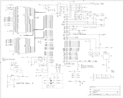

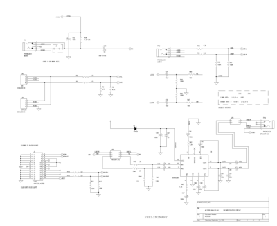

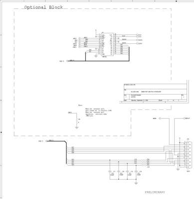

Reply 213 of 414, by Thomas_GER
Hi appiah4. I have a datasheet of the ALS100+ / 200 but it's not very detailed. Just three gif files but it contains the pinout of the chip and a reference design.
