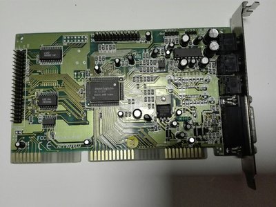

Reply 222 of 414, by Thomas_GER
That's indeed funny. I did not know that by now.
But here is a pic of mine:
235.63 KiB
4058 views
What I forgot: I don't think the card is damaged, more that it's chip or BIOS specific because I have a second one by another manufacturer wich has the same behaviour.

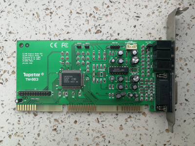

Reply 238 of 414, by th1r5bvn23
1.66 MiB
3120 views
I got this card several days ago... but I can't test it now. It does have a better position of gameport though. I'll solder jumpers for enabling/disabling amplifier.
Would you recommend this card over OPL3-SAx?
AMD K6-2+ 500, FIC PA-2013 2.0 (1MB cache), 128MB SDRAM PC100, Voodoo3 3000 AGP, Labway Yamaha YMF719B-S with NEC XR385
AMD Athlon 64 3000+, ECS K8M800-M3, 512MB DDR 400, GeForce FX 5200, SoundBlaster Live! SB0060
Reply 239 of 414, by gdjacobs
th1r5bvn23 wrote on 2020-03-02, 09:29:
Probably not. Compatibility on these is known to be worse than the Yamaha cards. However, it does have SPDIF I/O which is really interesting.
