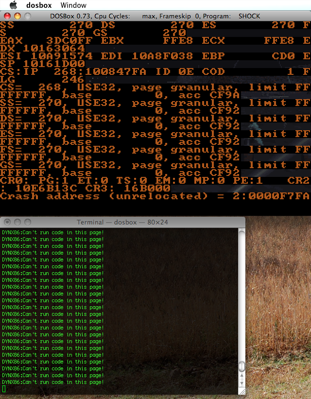

Hi, i've been trying to play Terminator Future Shock on my mac under dosbox, but can't seem to get it running past the introduction and the briefing of the first mission. Everytime the first level is loading, i get a crash of the game (but dosbox doesn''t quit, see the included pic to see what's happening in the dosbox window and the terminal window).
I am on mac, 10.5.7, intel chip, with dosbox 0.73, any help would be appreciated! Before posting i took a look at the forum to see if anyone had the same issie but couldn't find anything 🙁
Thanks a lot!

Won't likely run fast enough to be playable without core=dynamic, but it's worth a try.
Other things to try:
- make sure you've got the latest patch (http://patches-scrolls.de/ is a great site for old game patches)
- try using dos32a in place of dos4gw
Reply 3 of 17, by ben401
Switching to normal core did the trick, seems to be playable to me, but since the dynamic core crashes, i have nothing to compare to be sure 😀

Reply 13 of 17, by MiniMax
Rank Moderator
Moderator
ben401 wrote:
Seems to be a mac related issue 🙁
That is half-way to finding a solution!
Unfortunately, only the Windows and Linux versions are built by the core DOSBox team. The Mac version(s) are supplied by various volunteers. Which compilers, which optimization flags, and which 3rd party libraries they use are unknown.

Reply 17 of 17, by ben401
A little more investigation on my side 😀
I'm actually able to play Future Shock in dynamic mode on my mac too 😀. When I start dosbox in dynamic mode and loads a future shock games created on a previous session (made with normal mode), it's loading correctly and I can play... until the next loading point, that is whether the next level, whether each time you enter a door (a "loading" text appears on the screen each time for both of them).
So I guess the problem can be narrowed by saying that the loading points (each time a "loading' text appears on the screen) make the game crash in dynamic mode on mac. In all other situations, the dynamic mode behaves correctly.
