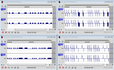

Here's the speaker patch updated against current SVN (r3995):
dosbox_r3995_digi_pcspkr.diff
23.5 KiB
72 downloads
and for testing purposes, a debug-enabled win32 build:
dosbox_r3995_digi_pcspkr.zip
2.79 MiB
51 downloads
I had a look at the reported Impossible Mission II regression. All versions seem to be affected, but there *is* a difference between the MCGA executable and the others:
- with IM2_MCGA.EXE, both the footsteps and the elevator sound are replaced with silence (padded with clicks).
- with IM2_EGA.EXE, the footsteps are still click-padded silence. The elevator makes a sound, but not the same sound as in unpatched DOSBox.
Perhaps the difference has to do with the fact that the MCGA version continuously messes with the timer, while the other versions do not. It does this over and over:
PIT:PIT 0 Timer at 72.5780 Hz mode 3
Some captures for demonstration:
IM2_comparison_WAV.zip
500.02 KiB
38 downloads
36.91 KiB
1211 views
Hope this helps. It looks like this patch generally improves accuracy in every test case I've tried, *except* this one. Are there any other regressions that anyone can see?
