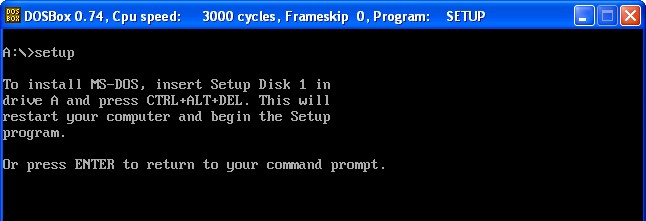

Hello folks,
first post in this forum, i really want to try MS-DOS 6.22 in DOSBOX, i Googled to find this thread in this forum itself: Can I install ms-dos 6.22 inside dosbox? , but no on seems to talk of how to install MS-DOS 6.22.
I would really appreaciate if someone could guide me, is their some kind of cmd line, i h' all the 3 DISK of MS-DOS 6.22 but dont know how, i h' installed it on Virtual Box , but i m considering switshing to DOS-BOS simply because it consums a lot less memory than Virtual Box...
i know a lot of people h' already installed MS-DOS 6.22 , can u please offer some suggestions....

    Scren shot of DOSBOX 0.74 while installing MS-DOS 6.22.

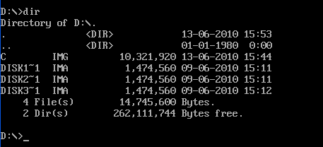

Hello folks,
thanks for redirecting, although i followed mirekluza exact same method made 10MB with Disk Image Creation Tool, and kept all the there DISK 1,DISK 2,and DISK 3. And kept in a d:\dosbox\ and followed this cmd line.
    3.29 KiB
    4405 views
    DISK 1 recognised as DISK~1.ima

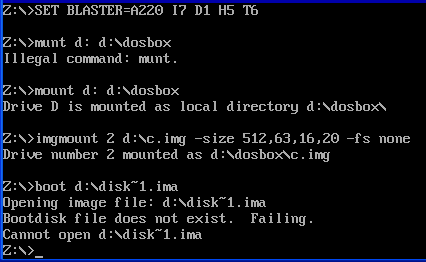

Reply 5 of 26, by Floppy
Well its asking for second disk:
mount d: d:\dosbox
imgmount 2 d:\dosbox\c.img -size 512,63,16,20 -fs none
boot d:\dosbox\disk1~1.ima
First disk booted ,and asks for second disk, entering wont work, so i had to press Ctl+Alt+Del then gave boot d:\dosbox\disk1~2.ima
Its says non-system disks ,press any key to continue...how do i beat that.

Reply 14 of 26, by Qbix
Rank DOSBox Author
DOSBox Author
maybe use file names without tildes
boot works on local files. so you need full names
Water flows down the stream
Reply 16 of 26, by IIGS_User
robertmo wrote:
d:\disk2~1.ima not disk2~1.ima
d:\disk3~1.ima not disk3~1.ima
I see the difference between this and the screenshot above. 😉

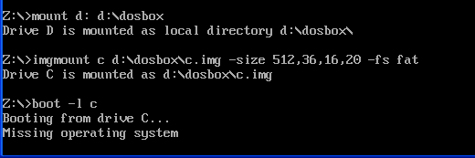

Reply 17 of 26, by Floppy
The cmd was working ie., BOOT [diskimg1.img diskimg2.img .. diskimgN.img] no need for -l d as described frm the manual:
Maybe it was a blind fluek or just i was lucky, i pressed Ctl + F4 and Alt + F4 and also Shift + F4 randomely and furiously and it then began to install.
May be its a DOSBOX buggy.
However i could not boot to the img file. As described in the TUT ie.,
mount d: d:\dosbox
imgmount c d:\c.img -size 512,63,16,20 -fs fat
boot -l c
But i can' tload the MS-DOS it say: missing Operating System:
Now whats with this: How do i load MS-DOS already installed.
    2.98 KiB
    4075 views
Reply 18 of 26, by Floppy
may be this is really stupid question. the above may not be the actual cmd. But i m not able to load or mount that c.img i.e.,ms-dos finished installing but unable to load it.Hope someone understood.. can someone kindly suggest how do i do that. As i said this is the first time i m installing ms-dos on dosbox. i m so close yet so far, any suggestion please.
