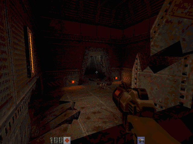

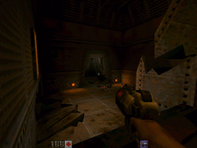

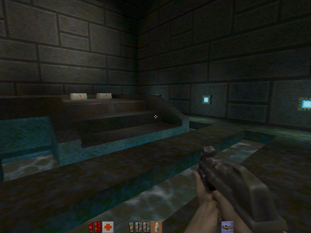

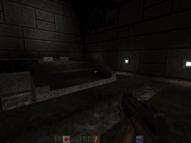

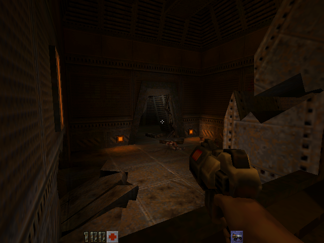

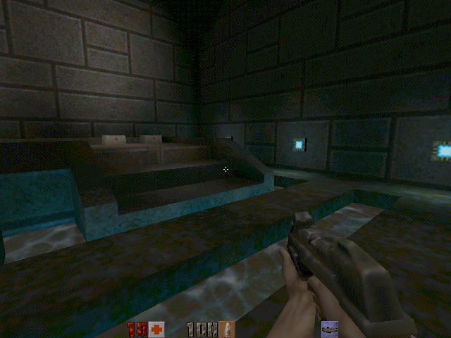

Reply 322 of 353, by leileilol
For my own study i've screenshotted a Quake2 scene on a Voodoo2 then on a Rage, then in software mode. Kinda fun to layer them over each other in a program and fading in and out to see the (already well known) visual differences. The Voodoo2 screenshot represents the common way Quake2 was seen throughout 1998, what with the high gamma and the blur. I loaded MesaFX on to take a screenshot without the filtering.
EDIT: Replaced screenshots with more consistent ones, and gamma corrected the Rage Pro screenshot

Finally browsing through this thread again, or at least the most recent additions before it went idle, but that Quake 2 comparison above is really interesting:
Retro 3D Accelerator Screenshot Collection
I haven't seen the Rage Pro dither like that before, or maybe it's just a weird circumstance in that particular scene, but it looks much more diffused and less ordered than most Rage stuff (or most 16-bit render dither patterns in general). There's some very ordered dithering looking bits (like the gun and water), but the rest is very diffused.
The Geforce just seems to use a much lower threshold and thus end up with mostly checkerboard dither at the expense of more posterization (like maybe truncating to 6-6-6 RGB before dithering to 5-5-5 or 5-6-5 output). Wish earlier cards had done that, it seems like a simple thing to do yet most seemed to try to approximate 24-bit color depth with lots more dither. (I always liked the low threshold dithered shading Tie Fighters DOS engine used, shame that wasn't more popular -in software renderers for that matter, given most opted for hard thresholding rather than any dither at all, even though pretty simple LUTs could generate 2-color alternating pixel outputs rather than single values for shading or blending -quake/doom style lighting could use it pretty easily)

On second look, I also think the software filter the 3dfxgl.dll capture is applying isn't as nice as the actual Voodoo 3's filter, it seems blurrier like single or maybe double-pass horizontal (scanline) filter effects some console emulators use to fake composite video blur. The real deal is NOT that blurry and merely softens the dither (blends it more at high res, but at 640x480 the pixels are quite apparent) and is pretty nice on the whole, all things considered. (320x240 is grainy ... not that you'd ever need to run that low, but for comparison purposes the filter is mostly useless -slight softening, no real blending, but I suppose nicer on the eye than full unfiltered output; the bigger deal is the dither patterns on the Voodoo are easily demonstrated to be nicer than Riva 128 or Rage Pro -or Rage II- )
Given the Voodoo2/3 GPU seems to do all the necessary computation for 24-bit framebuffer output (just dithers the 24-bit pixel results to 16-bit for the output) it's a bit of a shame they didn't include a 24 or 32-bit color option. (limited max res and fillrate compared to 16-bit, but that's true for plenty of cards with 24/32-bit options or all cards as far as resolution goes -would be nice for SLI given each board only renders half the screen anyway, texture RAM ends up fully redundant, but framebuffer RAM doesn't)
Plus the lack of dither makes running at lower res less of a problem. (and the Voodoo's filter still acts as a modes pixel-edge AA effect) Color banding (and dither) are fairly noticeable in Unreal's fog effects where they aren't in the Software Renderer's 32-bit option (or even Rage Pro's 32-bit) though the Voodoo 2/3 obviously has other quality and performance advantages.
