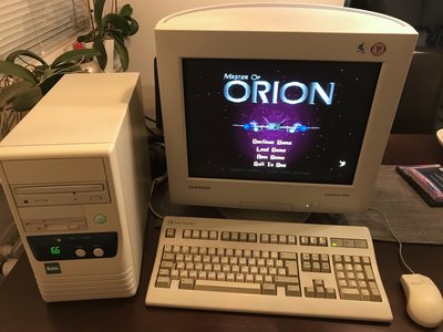

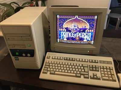

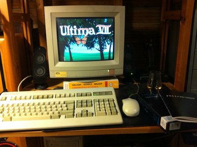

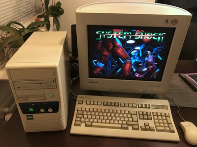

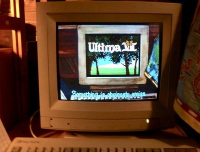

I'm slowly building a system to play early to mid 90's games. Finally found a case with turbo switch and MHz display. Still need to get MT-32 and Gravis Ultrasound.
AMD 486 DX/2 66MHz, 8Mb RAM
Sound Blaster 16 CT1740
S3 Trio64
14" ICL shadowmask display with all analog controls for older games
19" Samsung 959NF for newer games

That is indeed an awesome case, love the 90's pastel green power button. Also points gained for the period correct mitsumi CD drive.
Are you slowing the DX2 66 down for Ultima7? I found it ran too fast with all of those Mhz. System Shock on the other hand might struggle a bit at that speed?
Anyway cool system.

I'm really happy I found that case. Yes that power button color is really 90's! That quad speed CD drive might be the only thing I had left from my original system from 90's. I guess you can't save everything..

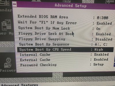

U7 runs too fast. I haven't yet tried how it runs with turbo off, but before this case I disabled caches and set cpu speed low from BIOS and it worked fine. I haven't found info what that cpu setting actually does - does it really lower clock rate or add wait-states like turbo button.
SSHOCK is definitely playable with max detail and full screen. I'd guess it runs about 20fps and drops a bit when there's a lot going on.

DX2-66 too fast for U7? Isn't it supposed to run perfectly on DX2-50? Or was that Pt.2? I forget..
Reply 1452 of 2742, by NuuttiS
Yes, the characters move like chipmunks on speed. A bit strange as U7 and DX2-66 were released both 92 if I remember right.

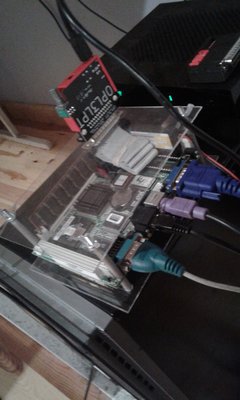

I'm trying to build a miniature 486 dx4 100, without fans. I love the biscuit pc industrial mainboards from advantech, because they are very small and you can find them easily on ebay.
So far, I have built this one, with:
- a pcm1823 mainboard boasting a dx4-s cpu, vga and 10mbps ethernet!!!!
- a 16 mb memory stick
- a 2gb transcend 44pin ide flash drive
- a sweet opl3lpt or a cvx4 depending on the mood of the day
- a poor man's case built with two pieces of acrylic, 8 small tubes and 4 screws & bolts.
- a 5v3a ext. psu
I like it a lot so here it is:
1.23 MiB
2362 views
my jan2019 dx4

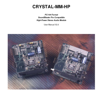

I've just bought this sound card from ebay:
740.29 KiB
2362 views
diamond crystal ess based soundcard
I plan to improve my setup with this ess based pc104 soundcard. I might get better compatibility. Can't wait to receive it!!!

33-40Mhz on a 486 is perfect. Any faster and the world speeds up comically. De-turbo should work nicely. On my DX2-66, the system would run the equivalent of about 20Mhz when de-turboed, which worked out quite nice on U7.
