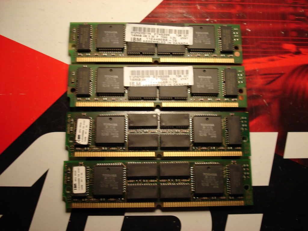

I think I'll revive this thread a little bit as a cautious reminder - There are a bunch of "5 V 72-pin SIMMs" on eBay right now which are in fact 3.3 V. It is important to look at the datasheet on the individual chips. For a set of FPM memory (4x 64 MB) I bought recently, the datasheet was kinda hard to find, but alas, 3.3 V was noted on the datasheet, with 3.6 V as the max. While the chips operated at 5 V on my HOT-433 for a good hour in Memtest (without errors), they got rather hot. Running this long term will certainly cause damage. I also just realised that a set of EDO 4x 64 MB chips I bought years ago is also 3.3 V, but were marked as 5 V.

I wonder if it is possible to cut the three Vcc traces on the SIMM module and add two 0.7 V diodes in series to drop the voltage down to an acceptable level? Two standard diodes in series would drop 5 V to about 3.6 V, which is within operating range of these memory chips. Or maybe I can get away with a single one of these diodes, depending on the operating current, http://media.digikey.com/pdf/Data%20Sheets/Ro … PDFs/rls245.pdf
According to the SIMM wiki, pins 10, 30, and 59 are Vcc.
Reply 47 of 55, by feipoa
I guess my double-diode SIMM idea is not so original. Attached is a module with four 4Mx16 chips, designated for 3.3 V. There is a double diode going to the three Vcc pins to drop the motherboard's 5 V to around 3.3 V at the memory chips. While that saves this particular SIMM from destruction at 5 V, my other set of four 64 MB EDO and four 64 MB FPM do not have diodes to drop the incoming voltage.
For those reading this who are not aware, a standard forward-biased diode, or rectifier, can often be used as a simple voltage regulator, with a standard drop voltage of about 0.7 V. The drop voltage varies slightly (non-linearly) depending on how much current is going through the diode and the ambient temperature. Forward-biased Schottky diodes drop about 0.3 V and Zener diodes, when reverse-based, usually drop between 1.8 and 36 V. For the Zener diode, you order the diode based on the reverse-bias voltage drop desired.
While I can still return my 3.3 V FPM sticks, I'll probably try the double-diode mod on my 3.3 V EDO sticks I ordered years ago.

I checked my 3.3V, IBM 64 MB EDO SIMMs, however the three Vcc pins are all inner layer traces, so I won't be able to attempt a modification on them. Another possibility is to add a 3.3 V option to the motherboard via a jumper using a header and 2 diodes. Unfortunately, this would require modifying all 72-pin SIMM motherboards and isn't so practical. I will count my losses on the 3.3V EDO SIMMs and look for a proper 5 V set.

This is my ram, there is 3.3v as for looking in the reference list for 71v65804 it would be an 3.3v 8bit 64megabit chip, as there are 4 on the stick, so it would be a 32MB simm with an BA033 attached in the middle.
The BA033 is a 3.3v voltage regulator, so i am a little puzzled why they would use a vrm on a simm stick, is this an attempt to use 3.3v chips to a 5v circuit?
I can try maybe on a different mobo, but i am a little afraid, tell me what should i do?

I used 3.3 V EDO SIMMs which had the double-diode down regulation on an M919 for 2 years without trouble. I measured the voltage across the actual chips while it was turned on and it was 3.3 V.
