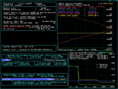

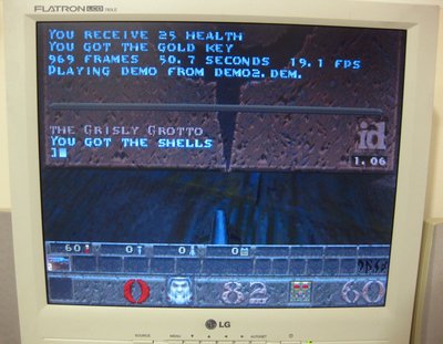

I pulled my IBM 5x86c-133/2x system out of the closet and re-ran Speedsys and the Quake 1.06 timedemo1 at 320x200. quake.exe -nosound -nomouse
I've attached the results. It reported 19.1 fps. As this is DOS, branch prediction is enabled. I'm using a Matrox G200 with Voodoo2. CPUMark99 reports only 6.14, but in Windows, I have branch prediction disabled.
Your Quake timedemo result seems a little slow for your hardware. Are you using Phil's benchmark pack w/Quake or Quake 1.06 demo by itself? I am using Quake 1.06 by itself.
Strange that Speedsys is misreporting the processor speed. Does your BIOS identify it as a Cyrix 5x86-133?
Did you investigate the 4DPS BIOS I supplied in the other forum?
Looking at the speedsys charts, it appears as if our L2 RAM is similar, but your system has improved main memory results.

I see it's timedemo2 on your screen shot.

That is because once the timedemo1 finishes, the timedemo2 starts automatically. The 19.1 fps is from the timedemo1 result, not timedemo2. How do you guys get timedemo1 to stop once the benchmark concludes? For me, the timedemo's keep playing in loop.
I am not using the benchmark from the Phil/Vogons pack. That pack has been tweaked to make it harder on Pentium-class systems, thus lower results show up on 486 systems. I"m using the original Quake Shareware version 1.06. Timedemo1.

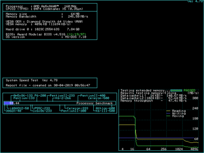

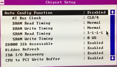

These are my settings for AMD 5x86-133-P75 over clocked to 160mhz.
I am having ram and cache performace problems.
I am using benchmark tools from Philscomputerlab.com
Computer works fine just problem playing MP3’s.
I am not sure if its the bios, CPU, or ram , or audio driver ?
How can I check ?

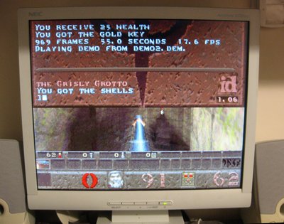

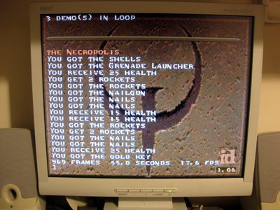

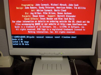

OK. Apparently the +timedemo demo1 flag works for the DOS demo 1.06 as well. I could have swore I tried this years ago and it didn't work; so I assumed it was for later edition of GLQuake . On my AMD Am5x86-160 system, I ran the timedemo with the +timedemo flag and thru the console directly and the scores were the same.
I'm using an S3 968-based VLB card in my Am5x86-160 system and receive 17.6 fps, however I've seen a similar comparison by another user in which using a Trio64 upped their scores another 0.3 fps. So perhaps 18.0 fps is possible with optimal conditions.
