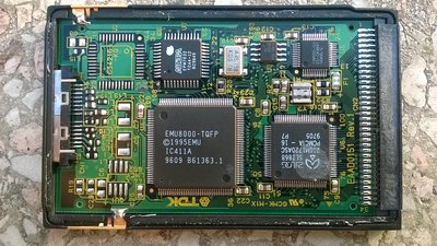

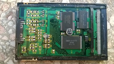

Reply 104 of 579, by Stojke
As expected the card can not pass sound onto the internal sound card or laptop speakers.
SHARP AD-AJ1.zip
1.1 MiB
120 downloads
Sharp AD-AJ1 driver disks
In other views, took one for the team (Although when assembled it´s barely noticeable it was disassembled):
1.97 MiB
3416 views
TOP
1.91 MiB
3416 views
BOTTOM
Id say from what I can see that the only difference between models would be the presence of the Crystal sound codec onboard, which means this card in its full edition is fully capable of generating an line level output.
The card it self contains an 512kB static RAM chip, which is confirmed to be used by the presence of an 241kB sound font on the first disk.
Would be nice if this were an at least 4MB capable sound card with actual outputs and not just for the Mini Disc player (As it says on the box - For MD-X8 exclusive).

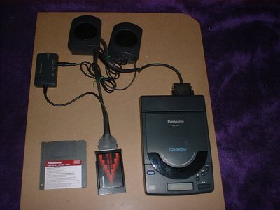

I purchased a used Panasonic KXL-D721 which I hoped to use with a Toshiba T4900CT I was restoring ..
The Laptop is now working but since I have no experience of external CD devices I am struggling to get the 2 units working together.
I did pop in the pcmcia card (scsi I assume) and windows 95 ..which is running on the T4900CT asked for the floppy driver disk..
Which I gave it ..and 95 doesn't complain any longer.
What is my Panasonic KXL capable of ..and is it compatible with Win95.
Should I be able to treat the CD as a drive D: in windows ?
Basically the pcmcia card is recognised ..but that is it ..
beyond that ..nothing.
perhaps I can only use the Pnany from DOS ?
help and advice welcomed.
rgds
VS
I've attched a zip of the floppy contents ..which is not labeled D721 ...but actually KXL-D740 ..which I find curious..but that is what came with the Panny
    KXL-D740.zip
    76.35 KiB
    106 downloads
    310.54 KiB
    3271 views

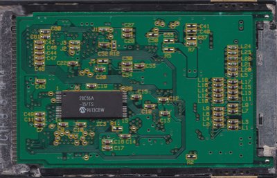

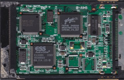

Some time ago I bought this KXL-D745 card which is defective, not recognized by any computer I tried it in, a problem with the tuple data perhaps, so I opened it to take pictures (scans actually) of the inside:
304.06 KiB
3213 views
288.78 KiB
3213 views
