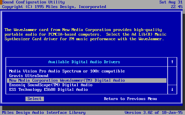

Ok... not 100% sure about how stuff is setup when they changed the name to Miles Sound System.
However, if you have a game that has some file that have a .dig extension and uses SETSOUND.EXE to setup the sound device, you should be able to add Wavejammer support to it if it doesn't already support it.
Basically you just get the driver files.
1. All .dig files
2. AILDRVR.LST (you can open this to get instructions on what to select for your card as well as how the card needs to be set up) - Basically select the Wavejammer for digital audio and Adlib for music.
3. Setsound.exe
You probably only need the first 2 but unsure if the different versions of AIL would need different versions of the .DIG files or not.
Just replace those files with the ones from a game that directly supports it and you should be golden.

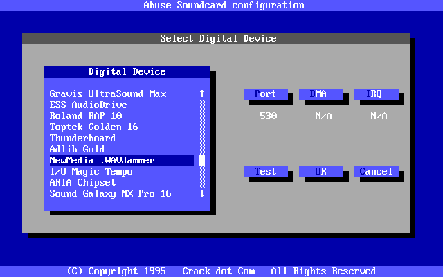

Reply 162 of 579, by lolo799
Abuse doesn't use the AIL/Miles Design library but the Human Machine Interfaces one instead, that's why there's no .dig files.
The demo version doesn't support the Wavjammer, the full version does:
5.31 KiB
2002 views
The setup from Destruction Derby, a game using AIL/Miles, as an example of what it looks like:
7.15 KiB
2002 views

So I finally received my Wavjammer card.
It's working fine in DOS as Adlib music source, however I did not manage to set it up for the
games that support it directly.
There are two drivers for DOS - WJSSENAB.EXE and WAVJAMMR.EXE
WJSSENAB.EXE requires only Socket Services loaded. Diagnostic
program detects the card and all tests are passed. It's also possible to set differet port
addresses. The card works in games if Adlib is selected. But the card doesn't work in games
that natively support it. Tried it in Abuse. I can select the card type and port, but test sample
doesn't play and conputer hangs.
WAVJAMMR.EXE requires both Socket Services and Card Services. Then it seems to
configure the card fine, sets port and irq. But Diagnostic program does not detect the card at all.
Let alone the games. It does not even work in Adlib mode.
Any ideas what am I doing wrong?
Edit: I'm using an IBM laptop and tried compatibility command line options - did not help.

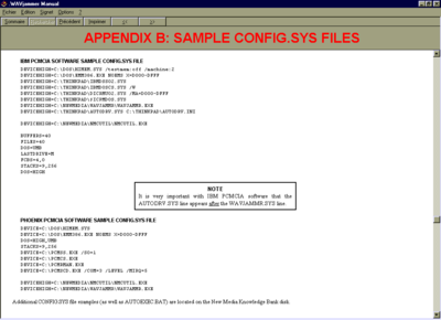

Reply 174 of 579, by lolo799
Did you specify the /COMP=GAMES switch as well?
Found this in the wj.hlp file:
13.46 KiB
1821 views
