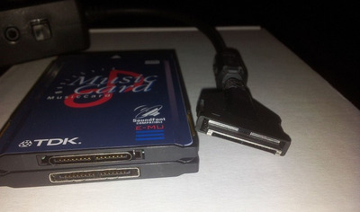

I am still looking for a compatible connector but I have pretty much run out of ideas.
SCP-55 seems to use a bespoke connector. At least I've never seen one like this on any card.
I would monitor Yahoo auctions to get another MCB-3 (pops up once in a while) and modify as needed.
Edit: Actually it reminds me of the connector of TDK MC/DMC cards but with more pins. The frame of both TDK and Roland cards is from Hirose. The connector must be also some custom\rare Hirose production.

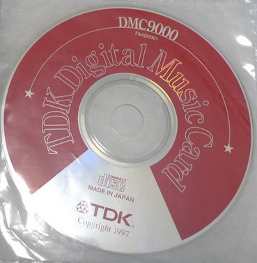

By the way, I'm looking for the CD that came with TDK DMC9000. Could someone image it and upload somewhere please?

Do you need the floppy images as well? I have a CIB TDK DMC9000.

Oh, cool. Thank you! No, just the CD please, I have the floppies.

Took me a while as I got carried away with getting the updates and translating the README files and update information for the archived TDK web page. This is everything including the floppies and updates:
http://www.vogonsdrivers.com/getfile.php?file … &menustate=38,0
Here are some more archived pages that should be of use. I may convert them to translated documents at some point:
http://web.archive.org/web/20010110201500/htt … 01/bda01010.htm - updates info
http://web.archive.org/web/19991013185349/htt … 01/cab14000.htm - FAQs
http://web.archive.org/web/19981201211244/htt … c01/index_2.htm - DMC9000 page ( formatting all messed up. This was the store advertisement page I think ??? )
http://web.archive.org/web/19981206194819/htt … 01/bda80000.htm - DMC9000 information page
http://web.archive.org/web/19981203031028/htt … sho02/index.htm - price list page
http://web.archive.org/web/19990224110047/htt … 01/dmc00200.htm - COMDEX announcement
http://web.archive.org/web/19990224122406/htt … 01/dmc00300.htm - feedback from users

Thanks a lot for the images, cyclone3d! It's very helpful to have all the links too.

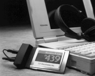

A couple of pictures of DSP Solutions PCMCIA sound card. Not sure it was ever released. The web page says:
OEM Basis Only! Contact us NOW!!
So it was supposed to be produced by third parties. Which they never did, I guess. Unless anyone have any evidences that this card was actually sold.
43.77 KiB
1700 views
11.06 KiB
1700 views
https://web.archive.org/web/19970219225810/ht … m/ds438new.html

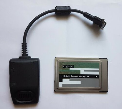

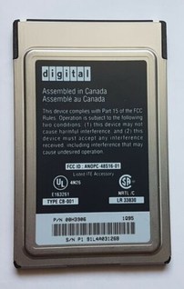

Hi, I acquired a PCMCIA Digital 16bits audio adapter, but I'm unable to get it working on DOS games. In theory that card is a clone of an IBM PCMCIA sound card (IBM 3D Sound Card, but I'm not absolutely sure). I'm working on a Toshiba T1950CS laptop, on MS-DOS 6.22 and windows 3.1. I installed the DOS pc card service and the DOS driver of the sound card.
Here are my Autoexec.bat :
PATH c:\DOS622\;c:\DOS622\CARDWARE
SET BLASTER=A220 I10 D1 T5
and Config.sys :
DEVICE=c:\DOS622\HIMEM.SYS
DEVICE=c:\DOS622\EMM386.EXE RAM HIGHSCAN X=CF00-CFFF (according to the Readme file, we have to reserve that address space for the sound card driver)
DEVICE=c:\DOS622\CARDWARE\PCSS.EXE
DEVICE=c:\DOS622\CARDWARE\PCCS.EXE
DEVICE=c:\DOS622\CARDWARE\PCENALE.EXE
DEVICE=c:\DOS622\AUDIO\PCAUDDD.SYS /IRQ=10
The sound card works perfectly on Windows. There is a PCDIAG and a PCDEMO dos utils on the driver floppy, the PCDIAG says all is good and the sound test works properly. On the PCDEMO, the test sound file starts but only for some milisec. I added the BLASTER environment variable and tried with several configurations. I tried to use the sound card with DOS games : Warcraft (the first one), JAZZ Jackrabbit, and Sid Meyer's Civilization (the first one). On Warcraft setup, there is a sound card autodetection, but it is unable to detect the sound card (tried as a sound blaster, sound blaster II, sound blaster 16, sound blaster pro, compatible sound blaster). None of those games are able to use the sound card. Any help is welcome 😀 Thanks.

This card is not a clone of IBM 3D sound card. It’s a clone of IBM 16 bit Audio Adapter. It does not work in DOS games at all, unfortunately. It comes with a wav/midi player for DOS. No other dos software is supported.
I would try to rem the emm386 in cofnfig.sys. It may prevent the card from working in pcdemo.

So sad :'( Thanks for the information ! If someone has one to sell... 😁
Did you checked this drivers?
http://nwserveur.no-ip.org/win3xorg/devices/P … dapter/drivers/
