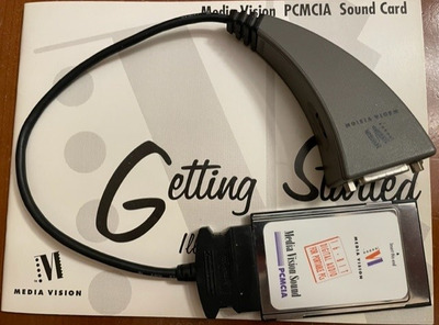

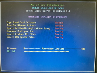

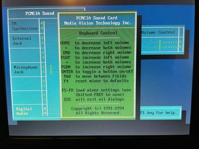

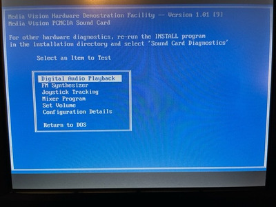

Reply 491 of 579, by Bondi
Got a Media Vision card recently. Tried it out, and found it really nice, one of the best cards. Detailed features are listed in the chart in by signature.
I tried it only in DOS so far on my TP 360CE that has Ricoh RF5C366 PCMCIA controller(Intel 82365 compatible). Software installation was fast and easy. The card needed no CS and SS, the enabler setsound.com sets Adlib (genuine Yamaha chip onboard) and joystick port and they work with any game I tried real and protected mode. The sound is loud and clean. Yet some hiss is present if there is no audio output or if the volume is maxed out. There is a physical volume control on the breakout box, which is very nice.
Sound Blaster compatible digital sound and MPU-401 port are emulated by vgameon.exe driver. It works also very well, but naturally it's limited to real mode games. I tried Wolf3d, Prince of Persia, Cannon Fodder, Duke Nukem 2. All worked with no issues whatsoever. I've read somewhere that Duke 2 is a picky game when it comes to sound, so looks like the emulation is very good.
It's also possible to connect a joystick and a MIDI device simultaneously (if you have an appropriate cable), all works fine.
The drawbacks in my view are that the MPU-401 is emulated and dosn't work in protected mode games. And also it doesn't work in Sound Blaster direct mode, as there is no hardware SB port. Overall it's a really cool card.

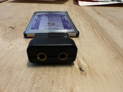

Reply 492 of 579, by Bondi
Ahother clone of Turtle Beach Audio Advantage card - Connectware SoundGear.

Some more Media Vision user experience.
Installation program

Demonstration program

Mixer
