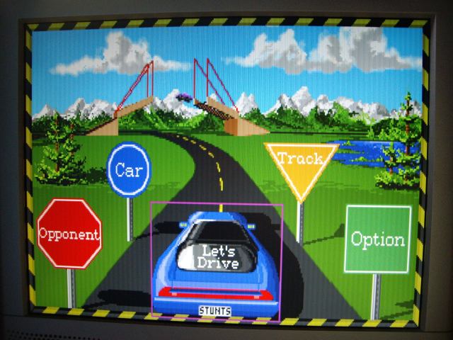

I also have a question about my new gfx card, the trident. It sometimes (though rarely) starts up in grayscale instead of color mode until I reset and it also has some kind of interlace effect going on, see the attached picture. Is it damaged?

I have a ISA trident and Tseng ET4000AX that does that grayscale thing. I looked into it a while back, and from memory it has something to do with the BIOS on these older cards. Sometimes they detect newer monitors as monochrome - there's an extra pin in the VGA cable maybe?
Anyway, there's a small util listed somewhere on these forums that forces the card back into colour mode, or as you've found, you can just reboot the PC.
The only permanent fix is to get another card, one with a newer bios. Given you're getting that getting that nasty interlace effect, you might need to do that anyway.

Im also using a trident card that does the grayscale thing most of the time. Using reset does not fix it.
Actually if you look at my signature, it is a direct reference to this and to what I said out loud the first time it happened. 🤣
In my case the only way i found to avoid it is with the help of my KVM switch. What i need to do is start the PC while the KVM switch is set to another computer. After a few second I switch it back and I do not get the Monochrome screen.
