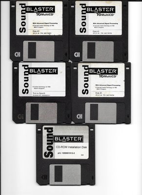

Dear all,
I'm struggling trying to find the first disk of this set, with this specific part number. I have all the other disks working - and attached here - but I couldn't find this specific disk 1 anywhere. I've checked also the large compilation CD file (I guess it was version 4.1) but I couldn't find it.
Someone recorded a boot disk for Windows ME over this first disk. 😢 So I would like to revert it! 😀

Sound Blaster 16 MCD Disks

What exact card is the disk set from?
On searching, I am finding a few different SB 16 MCD cards.

This is from a CT2230, that came bundled with a 2x CDRom that conected back to the board (not IDE), and with a bunch of games (Lemmigs and Indy 500) and Grolier Encyclopedia. I got the original kit somewhere in xmas 1994.

What did you use to create those disk images? I can't seem to find anything that will read them.
Found it, MagicISO is able to open them.
I have not been able to locate the English version of Disk 1 yet, but I was able to find the Italian version.

Sure! Post that version too! Of course I'd prefer the EN version, but I'm willing to take a look into that Italian version to see what is it about. And sorry for not advising on the disk format...

I'm not sure if you ever found what you were looking for, but I just saw your post and I have another variant of the CT2230: SB16 ASP. Mine didn't come with an optical drive.
I've uploaded the diskettes here:
http://www.vogonsdrivers.com/getfile.php?fileid=1135
I hope this helps you out.
