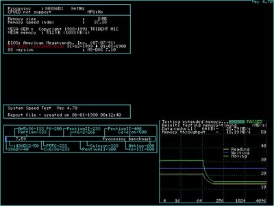

Reply 212 of 325, by Skyscraper
I do not think I have contributed to this thread yet, better late than never I guess. 😀
SPRING CIRCLE COMPUTER, INC. MDX340C/FOREX386 with an AMD 386DX33 and 64KB cache.
https://th99.bl4ckb0x.de/m/S-T/30013.htm
There are almost no speed related settings in the very bare BIOS setup so I ran Speedsys with defaults loaded, the memory throughput still seems decent for a 33 MHz 386.
