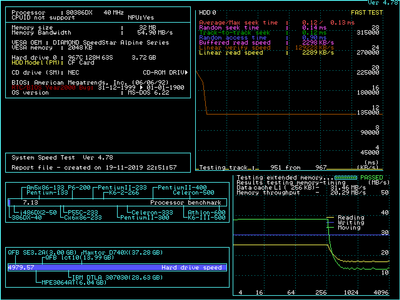

Here's my machine. Trying to make it the best possible 386 while still being a real 386. (So 486DLC, which i do have, doesn't count)
CPU: Am386DX-40
FPU: Cx83D87-40GP
Motherboard: M-321
Cache: 256kB + WriteBack chip installed
BIOS: Tightest settings available + AMISETUP used for some hidden settings
Memory: 8x4MB
HDD: CompactFlash 4GB
Also using XTIDE Universal Bios on a DE-250CT NIC. (NE2000 compatible card)

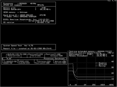

Reply 262 of 325, by stalk3r
Second run but this time with a 386DX instead of DLC. 21 MB/s is so close, but cannot jump it, no matter how I play around with the settings.

Reply 263 of 325, by Am386DX-40
Going by what GigAHerz and stalk3r posted, and my own benchmark found in the previous page (Re: Post your 386 Speedsys results here) we can probably asume that we hit the limit of the "real" 386DX-40 at 31 mb/s cache and 20-21 mb/s ram.
Stalk3r is using the same motherboard as I am, and the results are astonishingly close.

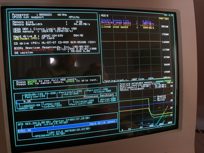

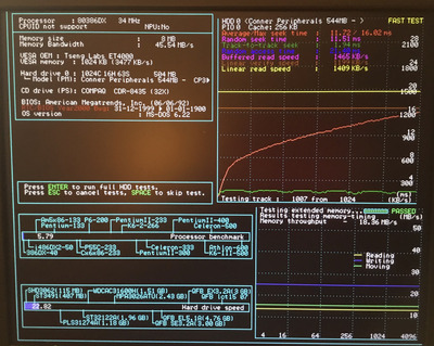

I didn't realise there was this kind of thread here before. I'll post my speedsys result here as well then.
Here is the thread where you can see all the parts: Early 90s 386 build as close to period correct as possible.
There are no other timing settings in bios except dram waitstates have been set to 0 W/S

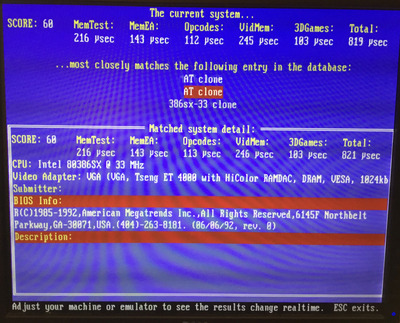

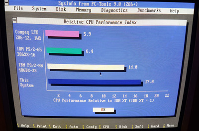

I also have this extra result from SI of pctools 9.0 that I thought was bit strange because it puts my 386 above that 486.

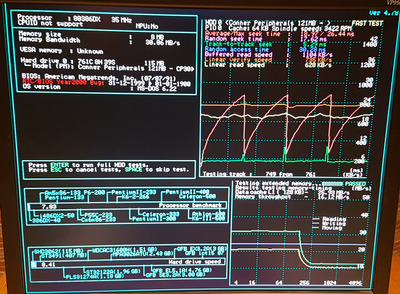

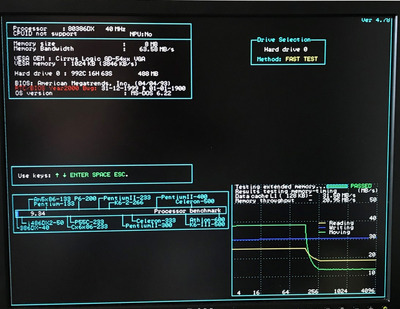

Dos 5.0A is installed
ALI - M1429 Chipset Motherboard
AMD 386 DX 40MHz surface mounted
8MB 8x1MB -70
Cirrus Logic 5429 ISA
Sandisk 1GB CF Card
LGS controller ISA
GoTek 1.44MB floppy emulator
SMC 8416 ISA 10/100 Network Card
Creative Labs CT1740 ISA Sound

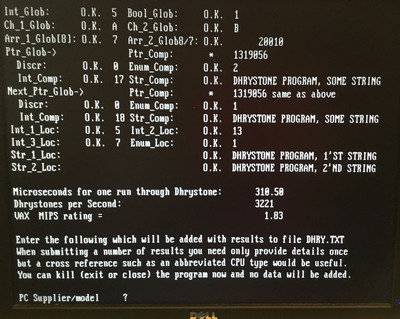

Reply 266 of 325, by FrankieKat

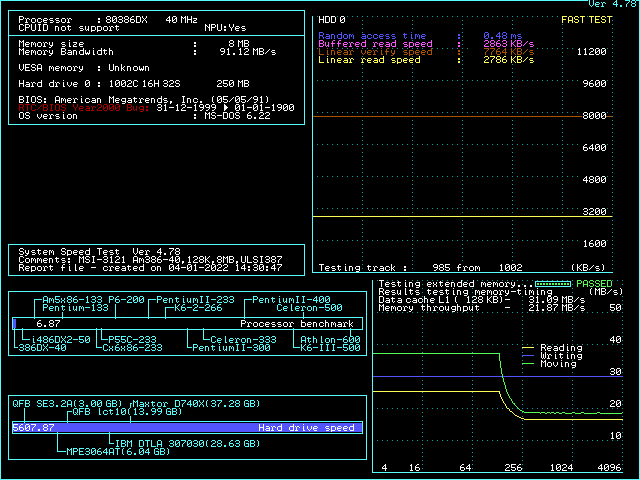

CPU: Am386DX-40
FPU: ULSI DX/DLC 40MHz
Motherboard: MSI-3121 Ver 3.0
Chipset: C+T CS82310 PEAK/DM
Cache: 128K Posted/WT Enabled
BIOS: AMI (options attached)
Memory: 8x 1M 70ns
HDC/HD: UMC UM82C862, 256GB CF (generic)
Video: ET-4000 1MB
Memory bandwidth is great, cache/memory speed is ok, CPU score is low since NPU is installed. This BIOS doesn't have a lot of the more standard options, and some I'm not really clear what they are ("TURBO Cache Function", "Back to Back Memory Cycles", etc). Any ideas what those are? Suggestions for tweaking performance welcome too!

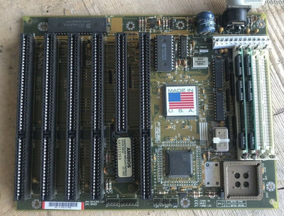

My "Made in USA" 386-33 build. AMD CPU with Intel math coprocessor.
its the computer that looks like a Mac Pro.
Link:
Made in USA 386 with Media Vision PAS16

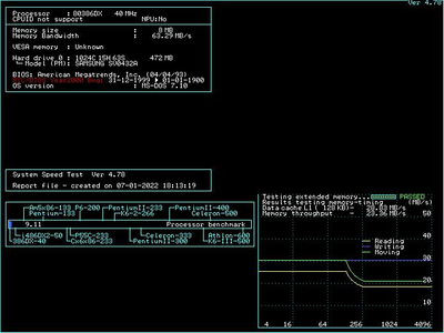

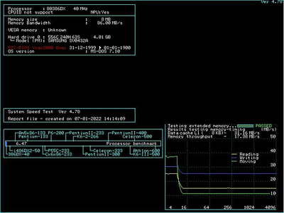

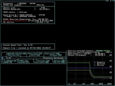

Been playing around with some of my 386 motherboards a bit so here are some results:
CPU: Am386DX-40
FPU: None (won't post with fpu installed, tried IIT and Cyrix, and various bioses with the same result)
Motherboard: Seritech SER-386ADIII
Chipset: Ali M1429
Cache: 128K Write Back and Write Through
BIOS: AMIBIOS
Memory: 8x 1M 70ns
It's interesting how with WB, L1 gains performance but plain memory loses performance... weird

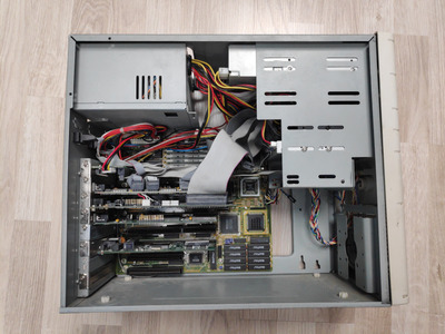

New board arrived, an Opti 495SLC 1.1 hybrid 386/486 motherboard. It came originally with a 486DX 33MHz, but I've downgraded it to an AMD 386DX 40MHz.
Also added 256Kb of fast 15ns cache, Cyrix 87DLC FPU, a Trident TGUI9440 VLB and a VLB Io controller (based on the Promise PDC20230c).

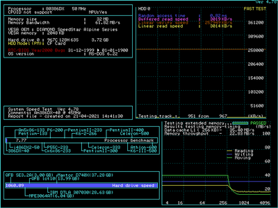

So, in the journey of making it the best 386 ever, i took the motherboard out and desoldered the crystal oscillator. Now i can replace it as i wish.
I bought 90MHz and 100MHz oscillators.
The 100MHz one doesn't even show clock being present on debug card. So i might have gotten 3.3V variant accidentally.
But the 90MHz crystal works! So it's now a 386DX-45! 😁 (Speedsys thinks, it's 50MHz, but MR-BIOS and chkcpu both confirm it to be 45MHz)
Also, in the mean time, i've gotten MR-BIOS on it. With tightest settings, it was equal to AMI bios with hidden settings adjusted.
Is that now the fastest world record true 386? 😜
