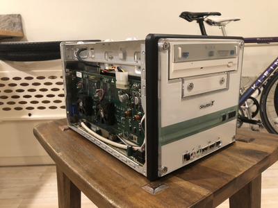

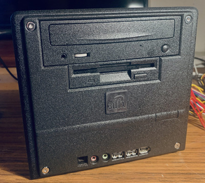

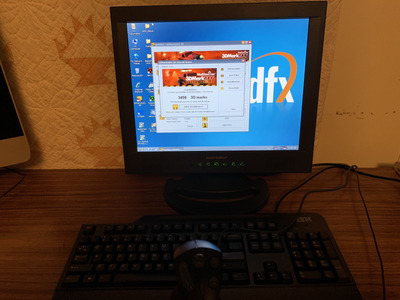

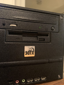

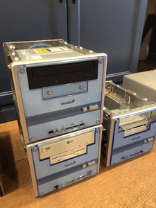

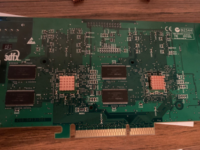

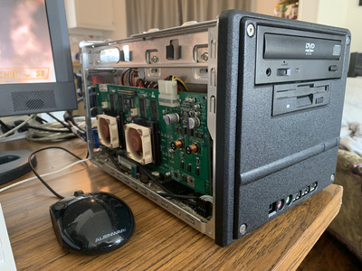

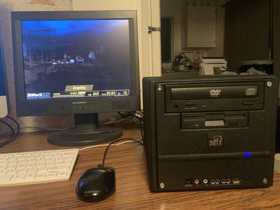

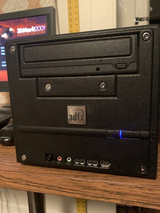

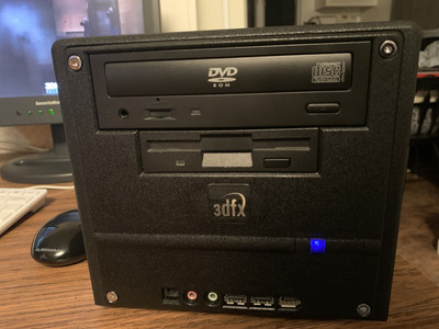

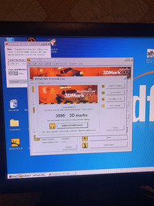

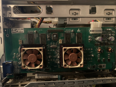

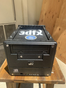

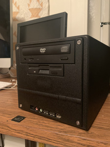

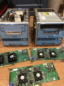

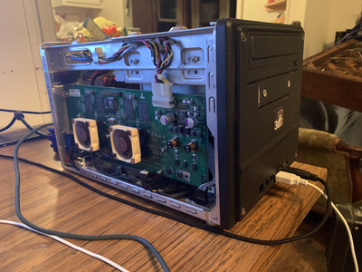

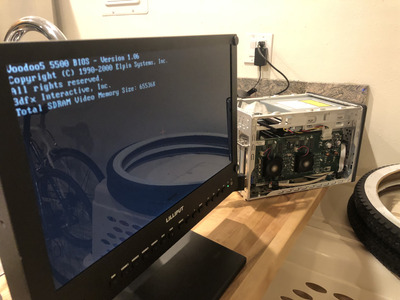

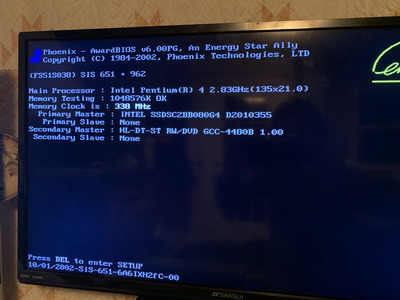

To add to this:

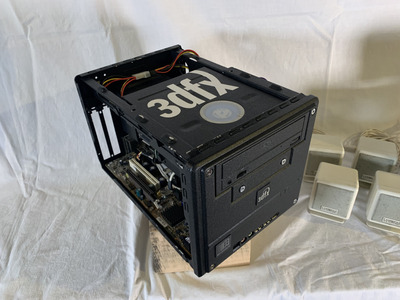

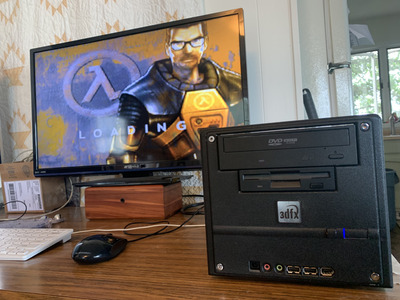

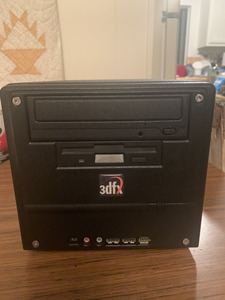

During the pandemic I wasted time building a few 3dfx systems I had been collecting.
First of all I love the Shuttle XPC form factor and so I greatly limited my options going this way, it had to be XPC.
without the top case on it is a perfect showcase for the voodoo5 5500 because the agp slot sits on the outside. It was just such a cool concept at the time that they shrunk the big box while retaining a lot of it's capability.
All systems used voodoo5 5500 AGP. I tried a few cooling methods. Biggest improvement is always open case and cold day.
My first build was SK41G - What I believed to be the best Shuttle XPC capable of universal AGP voltage. Barton 2800+ 266mhz is a little tricky to find but they are out there and it is a great system for the 5500. These systems are hard to find because 3dfx collectors know they are great performers, so are the 266mhz Bartons.
next...

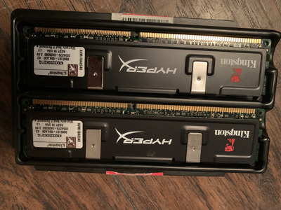

I discovered the SS51G and more specifically SS51GV2 (Allows Hyper Threading CPU) - these systems ran the Pentium 4 and still had Universal AGP. Now when you read articles from the past about Pentium 4 vs Athlon vs Pentium 3 you must remember, a 2.2ghz Pentium 4 vs. the last 3ghz is night and day. I will tell you the 2.8ghz and 3.0ghz Pentium 4 are screamers and will outperform the Barton and any Pentium 3 by a good margin paired with the voodoo 5.
I built a few of these systems based on SS51G. The FSB memory was able to overclock quite a bit and this change is what gave me record numbers from the voodoo5 5500 AGP. It was a bit of luck and I went through a lot of memory sticks to find those that liked overclocking.The Shuttle offered enough if not limited overclocking of the FSB which made the voodoo 5's fly. Overclocking CPU made little difference. Overclocking 5500 makes a bit of difference but FSB OC you can see directly makes the card run faster.
I know this is hard to accept: The fastest voodoo 5 AGP system is the Universal AGP Pentium 4 Mobo's paired with the 2.8ghz or 3.0ghz Pentium 4. No Barton will be able to achieve the raw speed of the 3ghz Pentium 4.
Pentium 4 from Athlon XP was the biggest performance gain I could find with voodoo5.
FSB overclocking makes big gains.

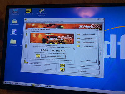

Voodoo5 overclocking is a small gain but quickly becomes unstable.
CPU overclock made a small gain but 3ghz Pentium 4 is overkill to begin with Voodoo5.
Air cooling the card front and back will give you the best results.
Maybe someone can shoot me down, I couldn't find anyone turning out higher 3dmark numbers except the 200mhz super cooled cards. Running stock 166mhz on the voodoo card, you will get excellent performance from a Pentium 4. I like that most 3dfx collectors poo poo the Pentium 4 because it keeps it cheaper for those of us who know.

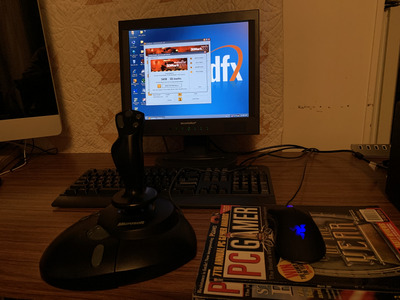

No real order to the pictures, you can see some of the 3dmark scores, I will try to find the highest.
Slowly through the pandemic I got better at painting...
