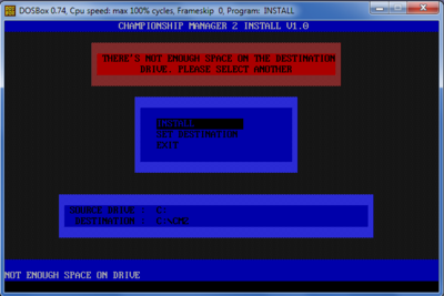

Reply 10 of 11, by CM2FAN
Hi everyone! I seem to have the same problem. The system is W7SP1, Dosbox 0.74. Still can't get how to check how much free space does DOSBox see. After launching Dosbox used "mount c c:/dosgames/cm2 -t cdrom -freesize 50" (though the installer wants just 10 or 30 MB) but still no result(( Please help!

Reply 11 of 11, by DosFreak
Closed.
Start a new thread with your own issue.
Also learn to read and understand error messages and how to mount in DOSBox.
Use the "dir" command to view free drive space in DOSBox.
