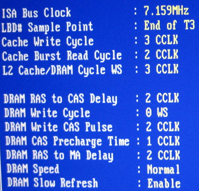

With 64 MB 60 ns @ 180 WT+8: 428 3DMARKS; 469 CPU-MARKS
With 32 MB 60 ns @ 180 WT+7: 427 3DMARKS; 469 CPU-MARKS
With 32 MB 60 ns @ 180 WT+8: 425 3DMARKS; 453 CPU-MARKS
In fact, the 3D-scores are equal; no difference between 64MB WT+8 / 64MB WT+7/ 32 MB WT+7.
That's why I choose to use WT+8 in generally (most stable) and set faster RAM-timings because of using of the RAM-module with 50ns.
I did every test only one time, so they can be a few points more or less.
Fortunately, 7bits did work for the test.
For sure, here are once again the BIOS-settings for 60ns I used, witch are equal for 32MB/64MB/WT-mode (appart from 7bits or 8bits)
