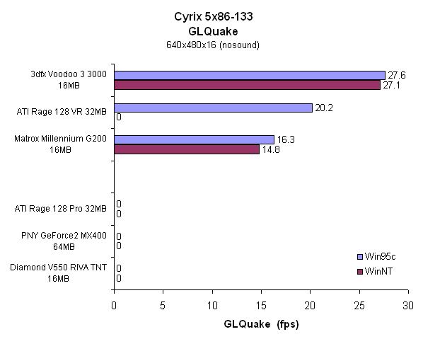

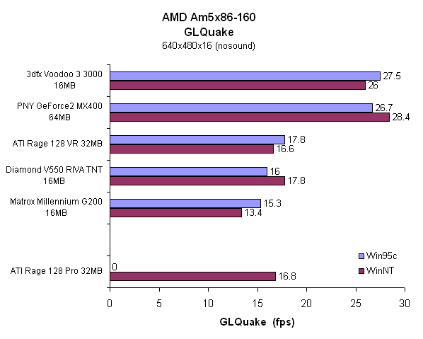

Reply 67 of 371, by feipoa
Here are some charts of the results thus far. I still have one mystery card to try out.
With these three socket 3 systems, I am wondering which 3dfx, openGL, and Direct3D games would now be considered playable when using GPU acceleration. My target frame rate is 23 fps+

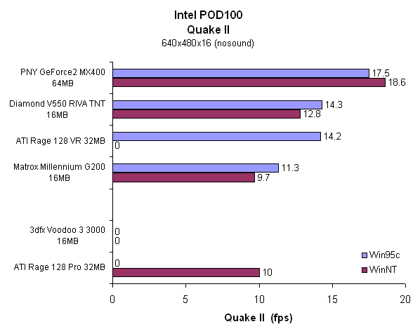

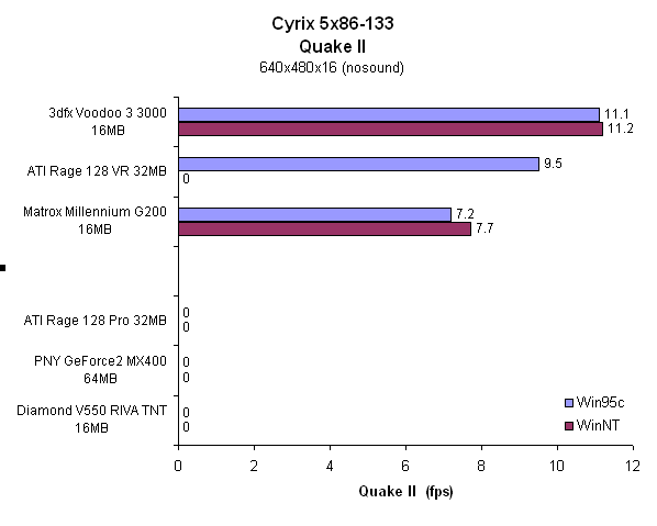

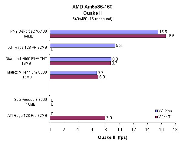

Reply 68 of 371, by feipoa
I wouldn't consider Quake II playable at these frame rates, but here are the results anyway.

Reply 69 of 371, by dirkmirk
Interesting to see the AMD-160 outperform the CX5x86-133 in Quake not that it really matters, is their a way to see the minimum framerates as the average doesn't represent reality, the slowdowns are huge in Quake on a 486.
Reply 70 of 371, by leileilol
GLQuake doesn't slow down as much since it doesn't update dynamic lights by default (unlike Quake2 which does). Dynamic light update = CPU eating + Slow bus transfer texture upload = 8048ouch.

Reply 71 of 371, by feipoa
Setting the gl_flashblend to 0 decreases the frame rate. It is set to 1 by default.
With sound enabled and gl_flashblend enabled at 800x600x16, the score is 24.0 fps
With sound enabled and gl_flashblend set to 0, the score is 21.0 fps.
