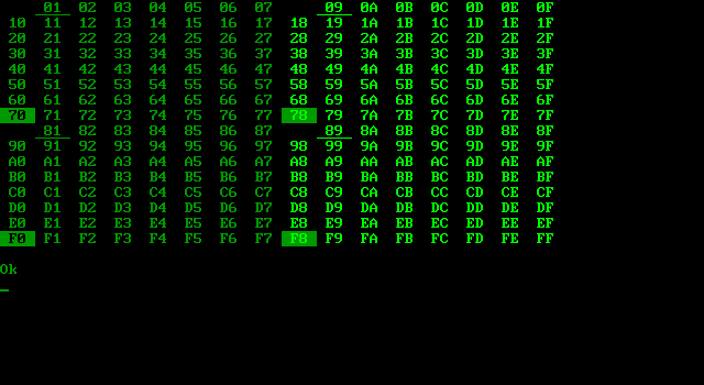

Pretty sure the original Hercules had just one 9x14 character set in ROM, so for underlined characters it superimposed a row of pixels, just like an IBM MDA.
DOSBox 0.74 supports both blinking and underlined text just fine... where exactly is the problem?

Maybe an old DOS word processor?
in GWbasic / QuickBasic you can use the "COLOR a,b" statement to get normal, intense, reverse, underline, blinking, and various combinations in monochrome text - see http://support.microsoft.com/kb/35148 (love the fact that MS still has this stuff up on the web).
This BASIC program will display a chart of all possible combinations, as in the screenshot above:
10 CLS : DEF SEG=&HB000 : LOCATE 18,1
20 FOR ROW=&H0 TO &HF
30 FOR COL=&H0 TO &HF
40 FOR I=0 TO 3 : POKE ROW*160+COL*8+I*2+1, 16*ROW+COL : NEXT I
50 POKE ROW*160+COL*8+2, ASC(HEX$(ROW))
60 POKE ROW*160+COL*8+4, ASC(HEX$(COL))
70 NEXT COL
80 NEXT ROW
Hercules was based on MDA, and a similar chart for MDA is here... there are a few differences from what DOSBox shows (maybe DOSBox is correct and Hercules really differed from MDA here, I don't know).
