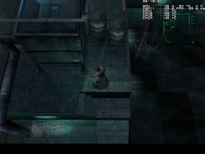

Reply 1143 of 3949, by ZellSF
Someone earlier said Metal Gear Solid worked, but I wonder if he tried hardware mode because something seems... wrong:
95.93 KiB
9507 views
The black bar is probably a side effect of this being a PSX port (Final Fantasy VII does the same annoying thing), but the water is weird.
Works natively. Works with DXGL (DXGL has other issues though).
