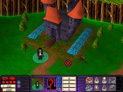

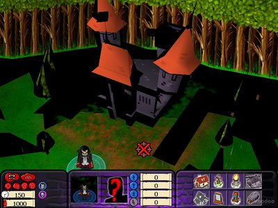

Universal Monsters - Monsterville has issues when graphics are set ingame to highest detail level:
130.16 KiB
2683 views
That for some reason get drastically better when you force resolution and texture filtering (performance related?). This game also benefits a lot from resolution forcing since it seems to be fixed at 640x480, though probably not a game you would want to play:
1.1 MiB
2683 views

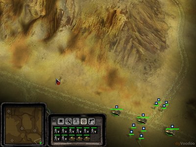

Cuban Missile Crisis works but feels like throwing you back into window mode whenever it's supposed to change resolution (and it switches resolution often). Doesn't seem to be an interesting game anyway. Resolution forcing works, though has a very negative effect on 2D text elements (that's not that apparent in this screenshot, but trust me it's a problem):

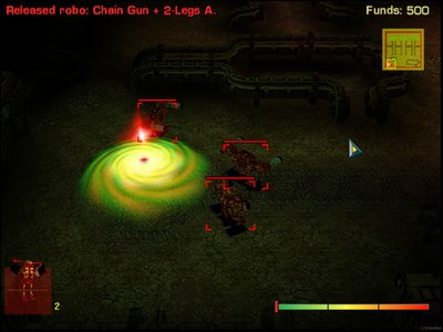

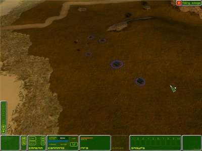

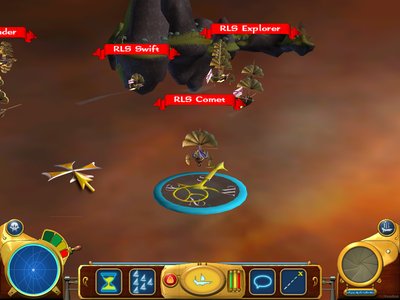

Moving on to games that actually look sort of interesting... Treasure Planet - Battle at Procyon works great. Resolution forcing works but has some negative consequences on 2D UI elements, arguably worth it as the game is limited to 1600x1200 with bad UI scaling:
643.57 KiB
2683 views

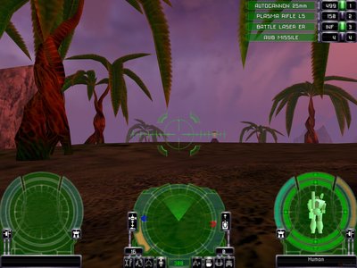

Machines works pretty much perfectly, resolution forcing works (and this too has bad UI scaling):
505.13 KiB
2683 views

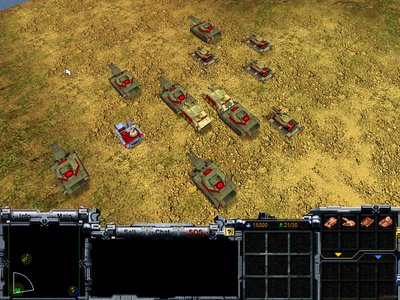

Knightshift works great. Doesn't need resolution forcing since it has perfect high resolution support out of the box.
