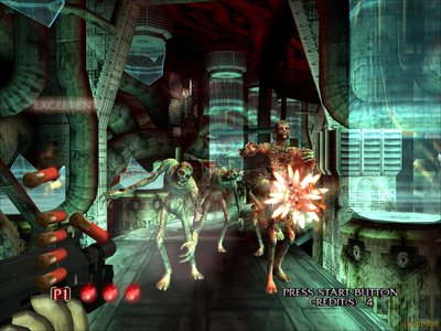

House of the Dead III works perfectly. Usually limited to 1280x1024 unless you feel like hex editing, needs a crack on Windows 7+. The game also works natively without dgVoodoo2.
