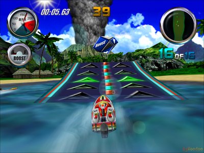

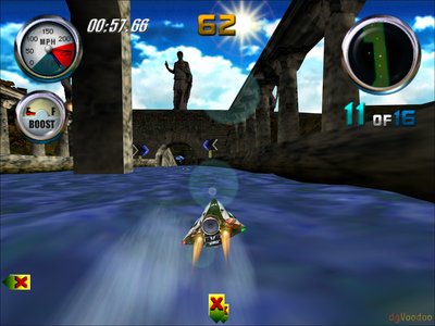

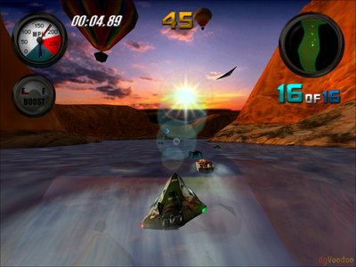

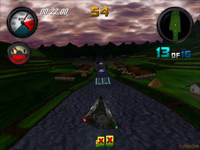

0 problem with Hydro Thunder (2001)...........frame rate seems limited to 30.
Dgvoodoo 2.55 @1600x1200 @MSAAX8 enhanced with 8x Sparse Grid Supersampling (nvidia inspector)
Config : ASUS PRIME H270 PRO / CORE i7-7700/ 16 GB DDR2400 / MSI GTX1060 6GT OCV1 @391.01/ Moniteur @1080p ...WINDOWS 10 64 bits V1803 @17134.285

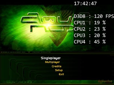

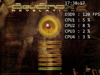

Hello guys,
Aquanox 1 has been reported working here with DGVoodoo2 and Google was no help at all, so i post this here.
The game works without DGVoodoo2 , tested with WIN7/64 GTX970,
but when running with DGVoodoo2 it crashes with the following error:
D3DUtil::BuildAdpatorInfoArray() num of display modes overflow
any idea what i can do about that ?
UPDATE: Ive just tried Aquanox 2 with the same error on DGVOODOO2 .
RJ

Reply 3767 of 3949, by ZellSF
Aquanox 2 is D3D9:
107.27 KiB
2689 views
Aquanox isn't and works with dgVoodoo2, but since dgVoodoo2 adds some extra resolutions (and maybe orders them differently than Windows?) then it crashes because as the error message says: too many resolutions. To fix either create a dgVoodoo.conf in the game directory (by clicking "Add" in dgVoodooCpl.exe) or edit the global one (in %appdata\dgVoodoo) and find this section:
DefaultEnumeratedResolutions = all
ExtraEnumeratedResolutions =
Set DefaultEnumeratedResolutions to "none" and add your the resolutions you want comma seperated to ExtraEnumeratedResolutiom. For example:
DefaultEnumeratedResolutions = none
ExtraEnumeratedResolutions = 640x480,1600x1200
67.24 KiB
2689 views
Reply 3768 of 3949, by RJ8
@ZellSF - THAT was helpfull ! Thank you so much.
I finally found out the following that might be interesting.
At least some retail (boxed) versions of AQ2 are DX8 , using the same engine as AQ1.
Ive got them both to work with DGVoodoo2 now after making the conf settings you have described.
There is a patch that updates AQ2 to DX9, probably download- versions are patched to DX9 already.
Thanks again !

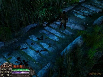

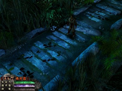

Ghost Temple has issues (textures?):
89.6 KiB
2566 views
Natively is fine:
89.14 KiB
2566 views
One of the few games that need MSD3DDeviceNames = true
