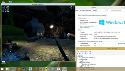

Reply 569 of 3949, by swaaye
Rank Moderator

lowenz wrote:
swaaye wrote:
AVP2 should work ok on modern hardware. What are your system specs?
It's a DX7 game, not DX8.
That doesn't matter. DirectX 7 games usually work ok on modern machines. I've played AVP2 natively on several DX11 cards.

swaaye wrote:
lowenz wrote:
Not on Win8/Win8.1 machines.
Reply 572 of 3949, by swaaye
Rank Moderator
Moderator
I beg to differ. 😎
280.49 KiB
2779 views
(I set it up for windowed mode for this shot, but it works fine fullscreen too. And it runs very smoothly.)
Reply 574 of 3949, by lowenz
swaaye wrote:
I beg to differ. :cool: […]
I beg to differ. 😎
"Very smoothly" in fullscreen mode.....I'll check later. Maybe it's because you have a solid system (i5-3570K, overclocked?)
Reply 577 of 3949, by swaaye
Rank Moderator
Moderator
I tried AVP2 on my Dell Venue 8 Pro and my desktop i5 2500K+ Radeon 6950 too. Both Win8.1. On the tablet it's not playable, only managing 5-10fps regardless of resolution or details. On the 2500K+6950 it does 23-30fps at 640x480 and 1800x1440. 🤣. Strange behavior for sure, some kind of vsync or rendering bottleneck. Lithtech 1/2 has always been a pain to get to 60 fps though.
I tried D3DOverrider and also disabling vsync in Radeon control panel to no effect.
Reply 578 of 3949, by ZellSF
did you use the DXPrimaryEmulation ACT flag with -DisableMaxWindowedMode parameter? Because on that setup you really should not be getting near that low framerates.
Reply 579 of 3949, by swaaye
Rank Moderator
Moderator
No I wasn't using that. I haven't been following this Windows 8 vs DirectX 7 issue much. I didn't know it was an issue until now! But now that you mentioned it, I looked into it. I found a replacement ddraw.dll that does the same thing. 60 fps with vsync is the result.
http://www.blitzbasic.com/Community/post.php? … 77&post=1202630
