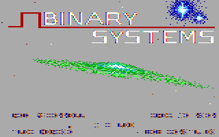

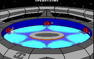

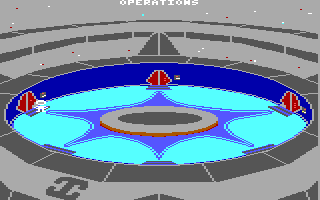

I just tested the EGA version (original floppy disks, but bitwise identical to GOG version) and pre-EGA version (from starflt.com) of Starflight 1 using machine=tandy and selecting "Color TV or Composite" or "RGB" modes (seems to make no difference for Tandy).
i noticed that with EmuCR SVN r3824 (and Ykhwon's SVN Daum 2013/02/05), the screen is light grey (dark white?) where it should be black. However, in 0.74 it appears black as expected. This appears to be a possible regression in Tandy emulation.
Screenshots from pre-EGA version attached.

    DOSBox 0.74 with machine=tandy

    SVN build with machine=tandy

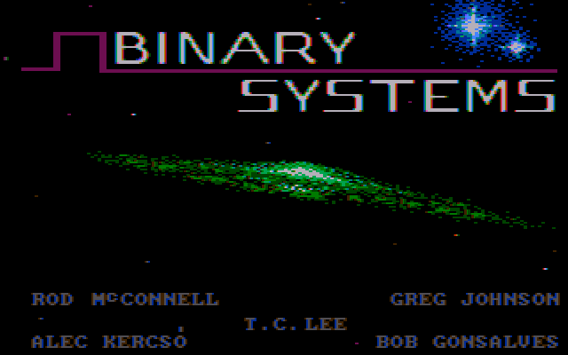

    Bonus: SVN build with machine=CGA

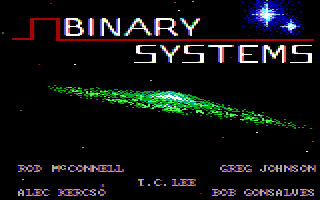

In stock .74, with the Tandy machine game appears type like this :
In the latest SVNs, vanilla and Yhkwong's, game appears like this :
The black background is correct, I confirmed it with my Tandy 1000SX. Obviously there seems to be an issue with setting the background color, since the other colors are unaffected. Problem is not limited to this screen.
