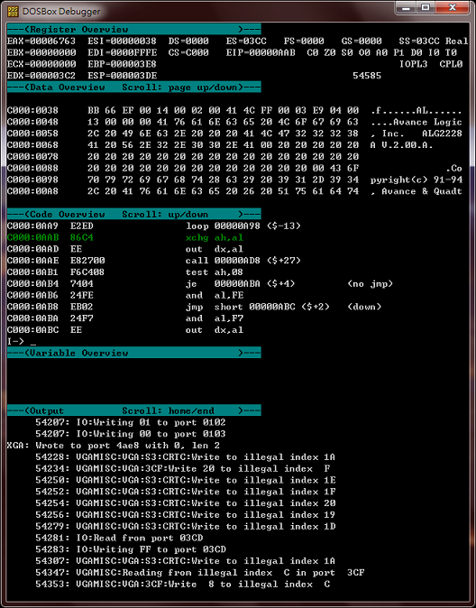

I ldgfxrom avance logic's bios, then install windows 3.1 driver for that card.
I would get this screen.
Just for personal favour, how do I change dosbox in order to make this card to work. Like what registers to change, sync frequencies etc
Can you point out what things I need to change? I have the avance logic's specification!
Thanks
Jack

Reply 1 of 4, by lucky7456969
Avance Logic ALG Graphics Accelerator
The ALG chips are VGA controllers with built in graphics coprocessor (COP).
The ALG chips only works in AT and better systems as they uses 16 bit I/O
addresses.
ALG2101 160pin 2Mb, 1280x1024x256c, 800x600x64k
ALG2201 160pin As 2101, but supports 24bit color
ALG2228 160pin 2MB, 1280x1024x256c, 1024x768x32k/64k, 800x600x16m
ALG2301 160pin PCI version of ALG2228
ALG2302
ALG2064 64bit memory bus, integrates 24bit DAC & dual clock generator and
on-chip 32K ROM
Support chips:
ALG1101 16bit DAC, controlled via I/O pin
ALG1201 15/16/24bit DAC
ALG1301 As 1201, but with video functions
ALG3102 Clock chip. Supplies 50.35, 56.6, 44.6, 72.2, 74.9, 65.1, 84.7,
79.4, 25.175, 28.3, 44.6, 36.1, 57.1, 63.3, 49.9, 39.7

I've got all these wrong indices writes, also I reckon dosbox doesn't report wrong index reads
