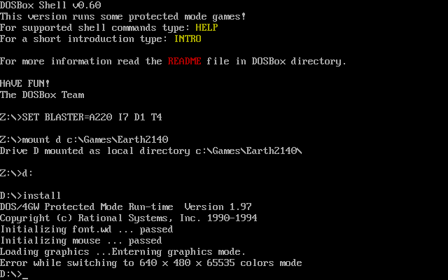

Reply 4 of 19, by **LASERLOK**
Thanks a lot folks... that's that hurdle overcome... however, solve one problem, and another takes its place... 😒
This time, it tells me there is an error while switching to the colour mode... help, please? 😖

Reply 5 of 19, by Qbix
Rank DOSBox Author
DOSBox Author
i'm not sure if 16 bit graphics mode are supported by 0.60
probably not as the game reports.

Reply 10 of 19, by Jiri
Harekiet wrote:
Oh yeh sure let's add 16-bit mode to see games crawl at a nice 1 fps, great waste of time
I think it would depend on the type of application. For example: adventure Ark of Time needs 15 bpp mode but its hardware demands are pretty low and this game would probably perform better in DOSBox than some 3D shooters running in 8 bpp. Just my opinion, of course, the 15 bpp mode is not present so it is impossible to run the game and test it. But you can add those modes just to prove that programers are always right and we users are wrong with our requests 😊 😊
Reply 11 of 19, by **LASERLOK**
eL_PuSHeR wrote:
Try using NOLFB in a batch file before launching the game.
Uhm, could you explain that in more detail please... what exactly is NOLFB?
Reply 12 of 19, by eL_PuSHeR
Rank Moderator
Moderator
SEARCH FORUM FEATURE AND GOOGLE SEARCH ARE YOUR FRIENDS. *sigh*
NOLFB (No Linear Framebuffer for short) is a nifty little app that "fools" your video card VESA support into thinking all video modes are "banked-only" (and old method of addressing video modes in VESA, slower than newer Linear with framebuffer but more compatible). YOU HAVE TO RUN NOLFB.COM BEFORE LAUNCHING THE GAME OR MAKE A BATCH FILE FOR IT.
To get NOLFB.COM, search this forum. I think there's a place where you could get all these apps.
