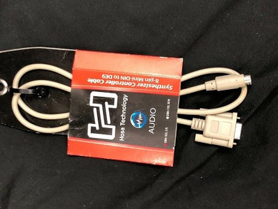

Tried SoftMPU with IBM Thinkpad 360CE with HOSA DBK-103 cable and output to COM port. Sound is working with:
- Dosmid player
- Lost Vikings
- HOMM 2
- Tetris Classic
Does NOT work with:
- DOOM 1/2
- Heretic
- Tyrian
- Raptor
- ROTT
Does anyone know why it's working with some games and doesn't work with others?

bjt wrote on 2021-03-10, 17:57:
Those later games use a DOS extender (e.g. DOS4GW), SoftMPU doesn't work with those protected mode games.
Thank you for the info. But for some reason SoftMPU works with HOMM2, which uses DOS4GW.
