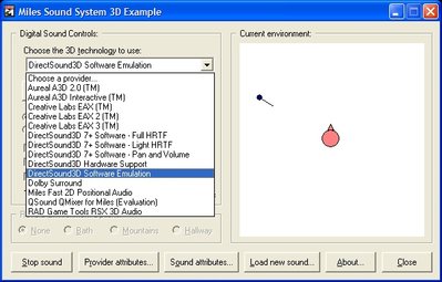

UCyborg wrote:
Yes, it is. Or why else would there be DirectSound3D Software providers available in the old versions of Miles Sound System?
Selecting any of these result in successful initialization on XP:
1. Yes, I was not precise enough. So more precisely: There is no emulated DirectSound3D on XP that gives you proper 3D positional audio contrary to Win Vista+. I have just tested on an 5.1 setup and none of the Directsound3D emulation modes on XP gives 3d positional audio, while on Win 7/10 Directsound3D software emulation gives proper 3d positional audio.
And this is the point I wanted to say: without hardware acceleration you cannot get proper 3d positional audio on XP, but on later Windows versions you can.
70.56 KiB
4785 views
Website, Facebook, Youtube
VST Midi Driver Midi Mapper
Reply 141 of 228, by UCyborg
Thanks for clarifying! So even though it actually does something, it gives incorrect results. And kills the performance.
Anyone knows how DOOM 3's DirectSound renderer performs on XP? I know you must have 5.1 option selected in Windows sound settings in order for it to work right if you pick Surround option in game's sound settings and that way it does work as expected on Vista+. I'd have to check to be sure, but going from my memory, this one doesn't use DirectSound3D at all, right? But there's an option to use OpenAL where 3D positioning works similarly as in DirectSound3D games plus its OpenAL renderer can use EAX 4.0.
