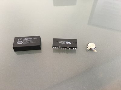

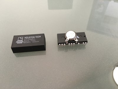

I placed this in an another thread, but I preferred the Houston RTC as there is no epoxy inside. Sadly, it is not compatible with the Dallas RTC pinout. It was very simple to change the CR1225 inside, just had to drop by Batteries Plus to get the tabs spot welded onto the new battery, which they did for free.
It would be great if the Dallas chip could be purchased without the cap or epoxy. All one would have to do it bend the pins upward and attach battery.
