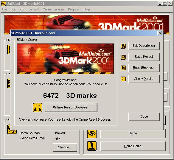

Ok, just thought I'd share my 3D Mark 01 benchmark for the Intel SE440BX-2 + P3 1ghz + GF4 TI4600 combo for anyone thats interested.
This was run using Direct X 8.1 and Nvidia drivers 45.23. 1024x768, no AA and game detail high.
Direct X 9.0c combined with Nvidia drivers 71.84 and 81.98 welded fairly lower results. I'm talking around 1000 points less than pictured so I find that Direct X 8.1 combined with the older 45.23 drivers the best combination.
