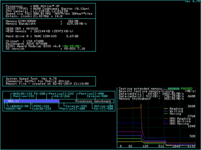

Today I finally set-up a system with an Athlon XP-M processor. This processor supports "Powernow!", and I wonder how similar the implementation is compared to the K6 mobiles.
SetMul v1.23 now works with the K7 Athlon XP-M, and theoretically also with the Athlon 4 Mobile. It can do 3.0x to 16.0x.
What is still pending:
- Check the maximum supported multiplier for each processor.
- Do a hardware check to verify SetMul properly detects Athlons without PowerNow.
- Maybe some diagnostic info on the voltage setting, since one cannot change multiplier without setting the voltage as well.
- Look into multiplier support above 16.0x.
- Look into K8 support?
    13.92 KiB
    2383 views

Falcosoft wrote:
Nice, as I said earlier I have no Athlon XP-M/Athlon 4 Mobile to test with, so could you test also my K7 hacks in A64LOWP by running ATHLON4.BAT?
I just tested it. The bat file somehow does not want to do the commands using these %1 switches. So instead I made the bat file simpler and ran all the options there: They work, and the processor speed that I read out matches with what was indicated in the bat file.
Falcosoft wrote:
Have you solved the chipset settings dependency in case of Athlon XP-M and desktop boards?
No, I just tried it on my A7V600 motherboard and Powernow switching worked right away. But thanks for the warning and the link.
Falcosoft wrote:
What's the problem with above 16x multipliers?
Nothing really, just that my SetMul source table handling for C3/K6/K7 maxed out 16.0x. But I just increased that to 24.0x this evening. To test it I modified my mobile Athlon processor with a small cut in the L6 bridges: Now multipliers up to 23.0x are accepted for testing.
Falcosoft wrote:
If you want to add K8 support to Setmul I can help and also the source code of K8 FID/VID setting logic is available in A64LOWP's package.
I appreciate that, at least for testing the K8, when I get to that part.

SetMul v1.23 is up!
  • AMD K7 mobile and K8 multiplier adjustment and readback.
  • Better checks in case of unexpected parameters.
  • Changed CWSDPMI version to 025 of 2006 as suggested by Mercury127.
  • Expanded and cleaned up SetMul.txt.
As Falcosoft wrote; It seems some motherboard support is required for K7 multiplier adjustment:
https://web.archive.org/web/20170822100906/ht … html/Tweaks.htm
Forgot to add that to SetMul.txt. Well, lets just see how it works for people.
K8 support could only be added with the help of Falcosoft, since he did the testing of the experimental versions and gave feedback to make it proper.
