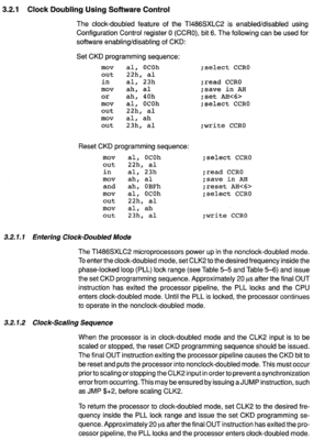

gerwin, would you be willing to add the Ti 486SXL2-50 and Cyrix DRx2 to Setmul?
Reply 45 of 228, by gerwin
I am not unwilling to look into it. Do these processors support software multiplier switching?
Could you provide me the datasheets (and the page number) describing the CPU registers that are concerned?

Reply 46 of 228, by feipoa
Gerwin, https://archive.org/details/bitsavers_tiTI486 … eGuide_19799789
The chip also has software enable/disable for the L1 cache.
Attached below is an excerpt from the SXL reference guide on the code required to enable clock doubling for the SXL.
