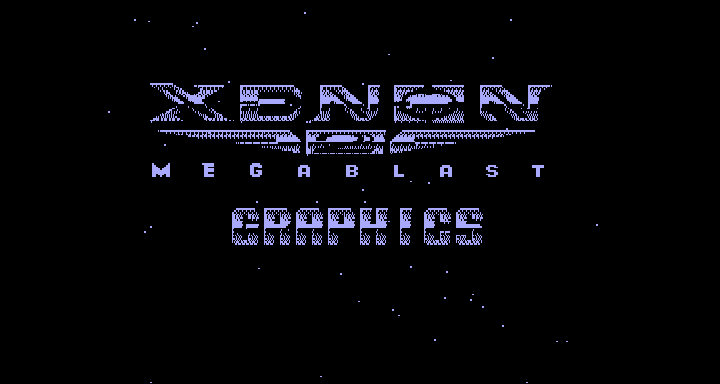

Just a short note to see if anyone else is making progress,
So far I've implemented the registers, but have yet to
gain access to the VGA memory space from the HGC space.
The graphics are chained like "mode-X" but with only 1bpp
Please let me know if the colour "bands" looks correct.
Also if anyone knows where I can tweak INT-11 to report
a HGC instead of VGA (or HGC specific software),
please list them!
A "screenshot" of work in progress:
    22.91 KiB
    3535 views
    Xenon2 intro

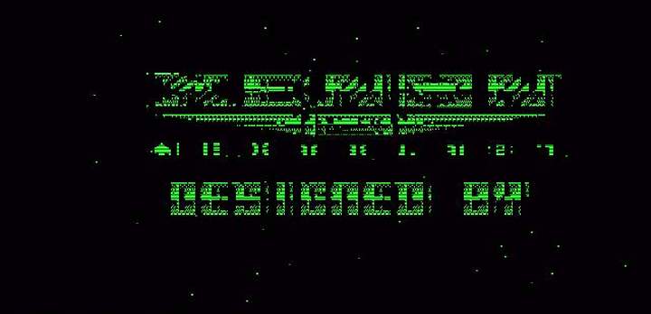

Reply 2 of 10, by taiken7
Was there a correct colour scheme?
Call it nostalgia, but my days lack monochrome "green"
(easy enough to program any other mono scheme, such as amber or grey)
Mixing 4 colours looks quite impressive too.
Resolution - 720X350 pixels and a beautiful 9x14 font set.
(I think VGA default textmode is 640x400 with 8x16 fonts)
(Still working on fonts..)
Reply 3 of 10, by Harekiet
Rank DOSBox Author
DOSBox Author
Default vga is 720x400 with 9x16 fonts.
Current CVS already has some support for hercules graphics mode though and you can further help detection of it with setting the machine variable in the config file
    2.93 KiB
    3520 views
    hmm why isn't it showing the pictures here though

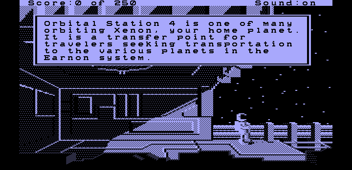

Reply 4 of 10, by taiken7
Thanks Harekiet,
Have the second graphics page up, not able to CVS so here is the
change you need to make to vga_misc.cpp:
-/* Hack around like it looks we are in 0xb000 segment */
- vga.gfx.miscellaneous=(vga.gfx.miscellaneous & ~0x0c)|0x0a;
+/* Hack so it it looks like we are in 0xb000 or 0xb800 segment */
+ if (val>>7) vga.gfx.miscellaneous=(vga.gfx.miscellaneous)|0x0c;
+ else vga.gfx.miscellaneous=(vga.gfx.miscellaneous & ~0x0c)|0x0a;
Now you can run any other hercules apps that dont make use of bios calls
(still finishing those).
    11.64 KiB
    3506 views
