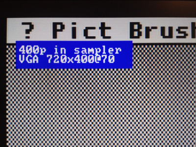

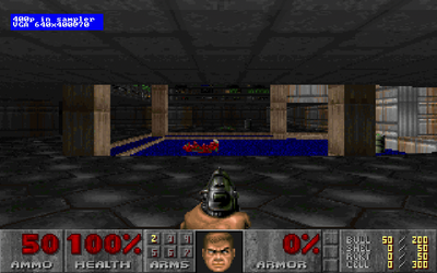

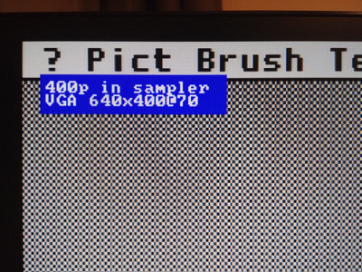

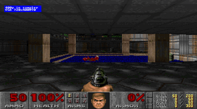

darry wrote on 2020-09-07, 00:23:
I am pretty certain that you have inverted your 720x400 and 640x400 sampling pictures . 640x400 sampling should be the one that displays correctly (proper letter width in Doom status bar) when VGA card is in 320x200 .
EDIT : I am really not sure with there are no sampling artifacts in your 1:1 VGA screen photo .
Darry, I just rechecked and I confirm the GTX 960 resamples 320 pixels to 720. I believe the pictures below should convince you (I've drawn a checker pattern in Deluxe Paint 2) :
Reply 262 of 295, by darry
cde wrote on 2020-09-07, 19:26:
Wow, I was not expecting that ! That means that they actually implemented a workaround for LCD monitor that sample at 720x400 . And since CRT monitors don't care, they will display correctly too ( you only lose some sharpness to the video card scaling 320x200 to 720x400 instead of line doubling). In an ideal world, being able to turn off this "workaround" for use with a CRT or external scaler or line-doubler .
EDIT: Not sure of this following part anymore. I will need to (re)-check.
Since my GTX750 Ti does 640x400@70Hz over VGA in mode 13h, Nvidia likely actually implemented this only in the last generation that does VGA . I find that quite ironic .
EDIT2: I was wrong about the GTX750 Ti doing 640x400@70Hz over VGA in mode 13h . It actually outputs 720x400 , if you can convince it not to upscale to monitor native (by depriving it of an EDID) .

When displaying 806p, the OSSC was receiving 1024x768 because the PC had booted into Windows . When I boot into DOS, I get 449p (probably the total number vertical of lines including active, porches and sync pulse) .
I also found the cause of the issue. It was the HDMI switch that I am using between the OSSc and the monitor ! For some reason, this switch that has no issues with all kinds of oddball resolutions generated by the OSSC from an FX 5900 or a Voodoo 3 somehow barfs when near identical resolutions are sent to it by the OSSC as processed from either of my GTX750 Ti cards .
Anyway, once I eliminated the switch:
a) I can confirm that a GTX750 Ti does not upscale to monitor native resolution over VGA when connected to an OSSC (probably due to lack of EDID), so same behaviour as cde's GTX960
b) I can confirm that a GTX750 Ti upscales (probably line-doubles first) 320x200 to 720x400 when outputting through VGA to the OSSC, so same behaviour as cde's GTX960 .

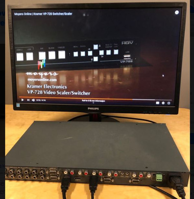

Anyone of you technically savvy peeps that have any inkling if a scaler/switcher can be used as a signal converter as well ?
- In particular this model : Kramer VP-728
https://k.kramerav.com/downloads/manuals/vp-728.pdf
VGA(in) to HDMI out (monitor) that is....

According to https://k.kramerav.com/downloads/manuals/vp-728.pdf the Kramer VP-728 seems much less capable than the OSSC for the purpose of DOS gaming:
- no mention of 640x400, so 320x200 games will probably be sampled at 720x400 leading to artifacts (doubled pixels). OSSC handles that problem by providing a 640x400 sampling option
- no guarantee that you'll get 70 Hz on the HDMI output
- no guarantee about the latency/input lag the Kramer VP-728 adds (the OSSC has no input lag)
The OSSC also provides a line doubling mode which is perfect for 640x480 (you get 1280x960) if your monitor has a 1:1 mode, in this way you have a pixel perfect image.
In short I would recommend getting the OSSC, and a monitor with a 4:3 mode (and optionally 1:1 mode) and can handle 70 Hz with no frame skipping. I use the AOC 2590PX (144 Hz with 17" 4:3 and 1:1 option) and darry uses the Philips 252B9 which provides a pixel perfect upscaling of 320x200 to 1600x1200, see I tested several pci video cards for picture quality in dos games.
