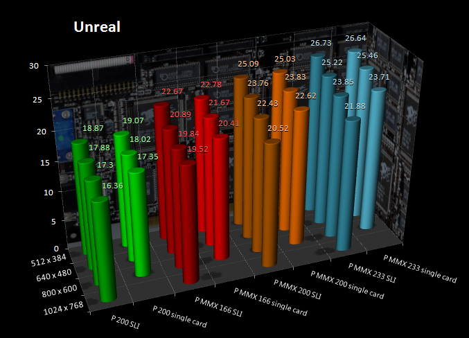

Then I thought about putting the results of several systems for one game into a graph:
I like how it looks, but couldn't figure out how to control the colours of the line (so that the single card and SLI results of one CPU are of the same colour).

Reply 3 of 7, by VileR
In that case you should go 3D... it's only appropriate in this context. 🤣
218.01 KiB
569 views
Reply 5 of 7, by VileR
Yeah, you can select a line graph, go to the Chart Tools -> Design ribbon, hit "change chart type" and pick one of the 3D types. Presets for each type are available in the "chart layouts" thingie.
Then the Format ribbon lets you play with rotations, axes, effects, etc. to your heart's content... takes a while to make it look passable though 😀

One thing to keep in mind here - if you want to present all of the data from 4 resolutions with 50+ combinations with CPUs and SLI in one graph it will look incredibly cluttered/complicated no matter HOW you have it draw, because that's 200 different points of data. Making multiple graphs will simplify that presentation dramatically. IMHO I'd do what the "big boys" (like Anandtech or Guru3D) do - graph per resolution with a basic bar chart, so you have a 512x384 chart that shows all of the CPUs and stacks whatever 20-50 high, and then one for SLI, and so on. You'll end up with 4-8 total graphics depending on if you separate SLI or not, and it will be much easier to view the kinds of trends you want to represent.
EDIT I do like that 3D graph though. 😀
