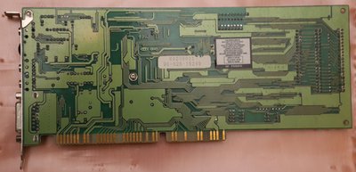

Thx for the info,windows98 identified the soundcard as a Media Vision Audio Deluxe/ProSonic/Jazz-16 installed drivers for it,only problem i got it's that the spk out doesn't work i'm getting sound only from the line in conector,i think it's something jumper related.

Reply 22 of 24, by Nahkri
LunarG wrote:
I take it you mean you only get sound from the "line-out", right?
No i mean the line in,as u can see from the picture the card has 3 conectors ,out,mic and in,i only get sound from the out conector.
I looked on the card to see if there is a jumper that maybe changes on which conector do i get sound but couldn't find any,here are some pics with the jumpers i found.

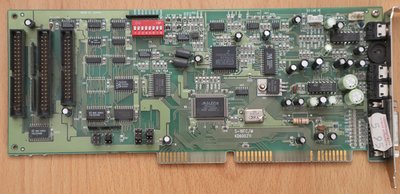

Reply 24 of 24, by Predator99
Zombie Thread, just like to report that I have a similar card running. First it appeared dead, but after switching some random jumpers (see photo for working config) it was detected by the install-programm.
device=c:\prosonic\pros.sys P240 I5 D1 E1 T330 Q2
1.73 MiB
61 views
1.75 MiB
61 views
Model: S-16FC/M
