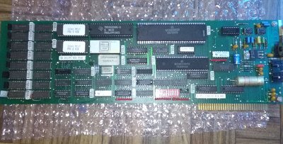

Well, with regards to the Swedish Mystery Card;
716.86 KiB
514 views
I've been in contact with Rune Tapper of Rune's PC Museum in Sweden, who was able to answer some of my questions.
The card is an Ericsson brand card, the model number uses familiar revision language. No word on what it was for/ I found out with a little more research that VOX (on the card edge) was (and is) the voice/telecom department of Ericsson.
Given that the card was found with a 1985 "Smart Answering Machine" from Dialectron (I can never remember that name), I still suspect that it was either for voice synthesis or voice compression and recording. I'm leaning away from research or radio and toward a more prosaic 1980s spam caller or voice messaging system, possibly an automated version of the then-common answering service.
If I can't find Ericsson's history department and a card catalog from the 1980s, the next step is to pull and try to read the ROM chips. I guess I had better get a programmer after all.

So... The swedish computer museum are more helpfull? I have tried asking the danish a couple of times regarding hardware. And they always reply, that I can become a member for an annual fee, and that there are lots of members that know stuff. Not helpfull at all. Vogon users are not asking for money, and there are more help to get here, than to get from the danish computer museum. It is as if they do nothing than fill a warehouse and keep the club as a closed coffee club. So sad.
