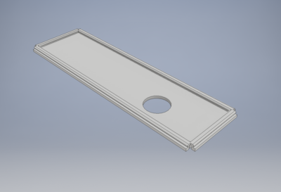

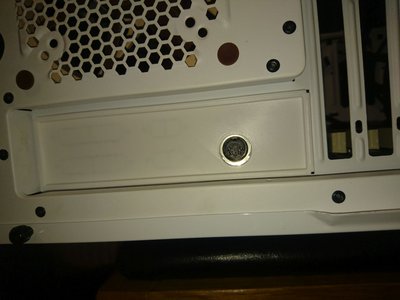

Thermalwrong wrote:
That's excellent 😁
Well done making that so accurately and thank you for sharing the STL files for it, I have a couple of boards I need to make something similar for, that I'd rather 3D print than try to make myself. Some of the designs on Thingiverse etc are quite good, but yours looks like it's designed very well, so I'll use that instead.
I bought a few blank panels, but cutting the shapes of a few of the ports is too difficult for me.
Hehe, well, turned out quite ok to be a first try at least. Had to keep it simple, used Inventor for the first time a few days ago.
Would recommend the recessed variant by the way, it works better. Attached another variant with the recess widened by 0.2 and deepened by 0.1 mm you might want to try too.
Yeah, metalworking is my thing, spent countless hours in the workshop, and would also say cutting shapes in that thin spring steel sheet would be very difficult without advanced tools.
gdjacobs wrote:
Noice. Any thoughts on an outer conductive coating? Apparently carbon and acrylic are a good, inexpensive solution.
There is conductive 3d printing filament that could be used for this otherwise, might get a spool at some point 😀
    blankIOwider.zip

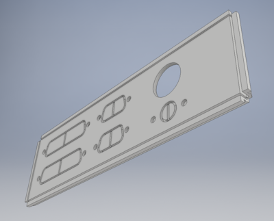

kaputnik wrote:
appiah4 wrote:
Amazing job. Now please make one for AT motherboards and post the file 😉
You mean a shield for using an AT board in an ATX case, with cutouts for the keyboard DIN connector, and mounting points for cable connected serial/parallel ports, or something like that?
Perhaps it would even be possible to do something for the PS/2 connector too, would be nice to not have to waste an expansion slot for that. If I remember it right, the screw hole spacing of those connectors seems to be standardized, so it should work.
Even if this wasn't what you meant, it's still a good idea. Entertained myself with it during the afternoon, happened to have an empty ATX case and an AT board not in use to experiment with. Even found a PS/2 port bracket to take measurements from. First prototype is printing right now 😀
Went up to 2mm thickness and generally made the construction sturdier, since everything but the AT keyboard port will be mounted directly to the shield. Made cutout indications for 2x DB25, 2x DB9, and 1x PS/2 port in the back side. Left 0.5 mm material, hoping that bridging will be good enough to make the indications invisible from the front side.
Tried to keep the DB9 and DB25 port cutouts as far away from the mobo as possible, those ports tend to take up quite a lot of room inside the case. The PS/2 port location is kind of experimental, hopefully it won't collide with the AT connector. Wanted to keep it away from the mobo too.
Will post the models once I've checked that it works 😀
549.97 KiB
1060 views
451.63 KiB
1060 views

kaputnik wrote:
Even if this wasn't what you meant, it's still a good idea. Entertained myself with it during the afternoon, happened to have an […]
kaputnik wrote:
These were exactly what I had in mind, hope they work out for you (and I can get some printed for myself once you share them *grin*)

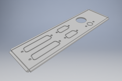

Reply 11174 of 27649, by kaputnik
Had to do some small modifications to the latching mechanism to make it easier to get the shield in place. Also increased the thickness in the cutout indications from to 0.7 mm, 0.5 mm left some roughness on the front surface, and modified them to be easier to cut out. Printing now, should be ready for testing in an hour or two 😀
432.65 KiB
996 views
Reply 11175 of 27649, by bjwil1991
Now that's something I'm interested in printing myself. The design looks pretty stellar.
Reply 11176 of 27649, by kaputnik
The second test print turned out quite okay, but I'm still not fully satisfied. There's still some surface roughness at the DB ports cutout indications, so tomorrow I'll try to narrow them down a bit and go back to 0.5 mm thickness.
After finding the connector for the PS/2 bracket, it became obvious that it'll never fit above the AT port, got to move it somewhere else.
The modified latching mechanism works very well though 😀
Also got a few other small adjustments in mind.
130.22 KiB
973 views

kaputnik wrote:
The second test print turned out quite okay, but I'm still not fully satisfied. There's still some surface roughness at the DB p […]
Amazing! Really looking forward to an STL that I can get a couple of printed locally 😀
