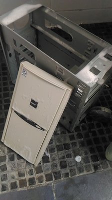

Cleaning day! Gave this recently aquired case and a bunch of other components a bath.

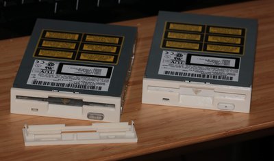

The last couple of days, I've been making new bezels for things, as part of a larger project.
My LS120 drives, the ones that came from external caddies, they have the button and the cover flap but of course since the bezel is part of the caddy, they've been left faceless for a while.
I made up a replacement for it, which accomodates the external caddy version's larger eject button in fusion 360:
178.62 KiB
1885 views
I copied the design from a regular 3.5" internal LS120 drive so now they all have faces 😁
They just snap into place, maybe I'll make the LED cover in fusion 360 once I've got some transparent filament:
439.08 KiB
1885 views
Usually my designs take 3 or more tries to actually fit the object they're meant to fit onto, but these snapped into place first time, wonderful 😁
