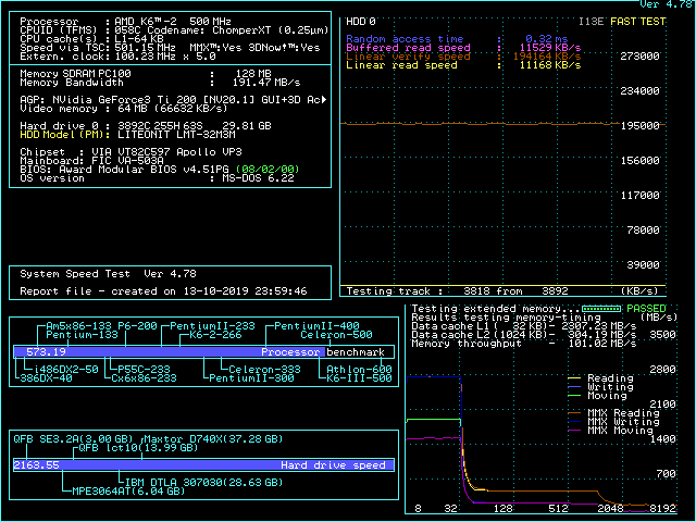

After some difficulty, the FIC VA-503A board that I got in the scrap box is working! 😀
It's got 1MB of L2 cache, which makes it maybe better than the Asus P5A-B? Time to see which one comes out on top.
It does not want to run its memory at 100MHz, just beeps at me when I try 100MHz FSB and 100MHz Memory, even with nice Crucial PC100 CAS2 memory. I wonder if recapping it will help with that? Looking at the other thread on MVP4 poor memory performance, it seems that mine's running quite a bit below par right now.

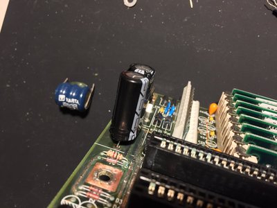

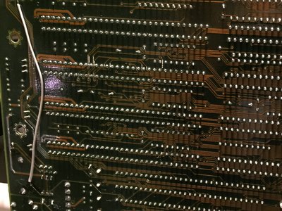

Not today, but last Sunday I decided to try the super capacitor mod on my 386 and also tin the badly corroded traces.
The attachment repair-1.jpg is no longer available
The attachment repair-2.jpg is no longer available

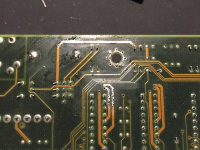

The keyboard would occasionally stop working on this board and apparently I made it worse when I scraped the corrosion off with a fiberglass pen: keyboard interface error at POST.
The attachment repair-3.jpg is no longer available
I ohmed out the suspected trace and found the problem. Then I got a bit of ribbon cable and tacked it on. It works perfectly now. The super cap also seems to be working, but I need to test it more.

That's a good thing though, right? It's much easier to track down a straight up broken thing problem than an intermittent fault 😀
Have you had a chance to test how well the supercap is working out? Does it store for just a few hours, or can it manage days/weeks?
Nicely done, I've had to do the same on 2 of my 386 boards now - same thing with the keyboard just not working courtesy of the battery acid.

Yes you're right. It made it a lot easier to diagnose. As far as the super cap goes. I'm not sure how long it will store the CMOS data and keep the clock running. I have run the 386 for an hour tops, then had it off for an entire day and it kept the data. I'll keep it off for a week and report back.
My TG16 CD and Turbo Duo both use super caps to keep the save data, and I know my Duo can keep its data intact for a year. It has a tiny capacitor in comparison, but it has no clock. I have since upgraded it's super cap and it should last a while.
I've only seen people do this mod with .5f and 1f caps. The super cap I'm using is a 3.5f 5.5v Illinois brand. I hope it will maintain the data for at least six months.
