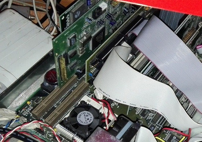

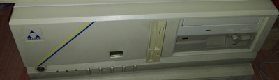

Today i have finished troubleshooting a really stubborn 486 desktop PC.
54.96 KiB
542 views
Always had intermittent issues,losing cmos memory data. Especially when moving it or bumping it. I was testing some 'new' cards in it,including a VLB video card (which works fine) when suddenly the issue worsened.
Started giving me a 1-3 1-3 Phoenix bios message every reboot.
Removed ide controller,as well as all the other addons,changed video card and memory, nothing changed.
Since it has a modded DS1287 , tried another one, with no luck.
I've decided to check the motherboard for loose solder joints, reflowed the keyboard and power pins, no luck.
Then i checked the DS1287 socket and i've found out that some pins were horribly loose. Decided to replace it with a brand new socket.
The PC came back to life, no more errors and the CMOS memory holds after the reboot. All those years of intermittent problems for a stupid socket...
It has a nice Pci/VLB/isa combo motherboard, Expertboard brand. 486 dx2 66, 32 megs of ram, sound Blaster 16, 28.8k modem, 3com LAN,and a 270Mb hard drive. Generic s3 pci card from '96 as video since i have heaps of them.
91.28 KiB
542 views

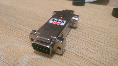

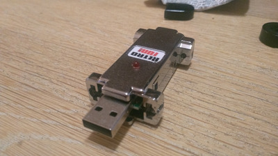

Got this working on my "TheC64 Full Size", and then wrote a blog entry about it....
Played a lot of 1942, PacMan and Winter Games today, on TheC64 with my TheArcade stick.
Love it... 😜

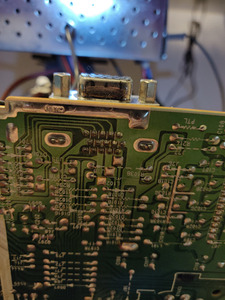

I have spent FAR too much time trying to coax an early 2000s Yamaha 2.1 system back to life. Basically, the plastic part of the inner barrel connector broke off and got stuck in the plug in part, which messed up all the pins. I had to draw several maps of the wires, decide on an alternate connection (by default it was VGA, both a burned out ISA video card and several thousand VGA cables were at hand, had I had more time, I would totally have selected RS-232 but really, this will do), and then cut the housing, trace the wires, solder everything...
VIGOROUS heat gun application to remove the old socket from the board!
Then some soldering:
Connecting the VGA to the 2.1 control wires:
Kinda weird to see a VGA connector on a speaker system:
And upon connecting everything together - popping sounds!
The culprit - the POT here was split down the middle and caused all sorts of issues (this was at the other end of the control board):
I stuck in a 10k POT for now, it works, but I can't adjust it as it is entirely the wrong format (pot adjust shaft extends into the housing)

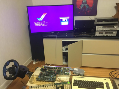

And this morning I replaced a RAM-chip on an early VIC-20, and then the same fix on an C64 breadbin. But sadly the SID-chip is dead on the C64.

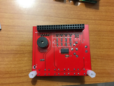

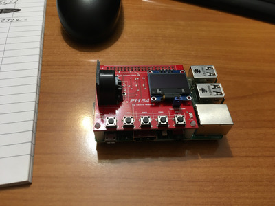

And while the iron was hot I also soldered up an Pi1541 to try out.

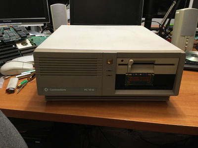

Almost forgot. Some time ago I cleaned up this PC 10-III. I don't have any keyboard to try it out, but someday.

oooooo... that's pretty!

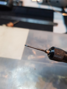

I've finished replacing the crapcaps with Panasonic ones. It's been 15 years since I've recapped a mainboard (back then it was also a S370 from a Shuttle mini-pc).
As a complete soldering amateur, I could not get all the solder out of the holes, I made my own minidrill from a fine screw driver. It's probably not the proper way to remove solder, but unorthodoxy is not a sin in my religion.
125.17 KiB
355 views

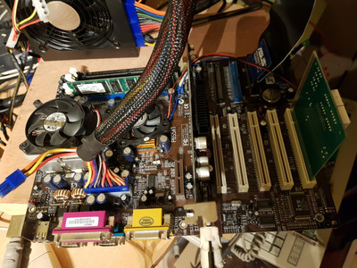

The full board running:
434.6 KiB
349 views
Nice ! Good thinking and I may try that method too.

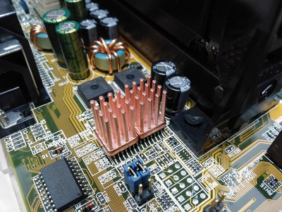

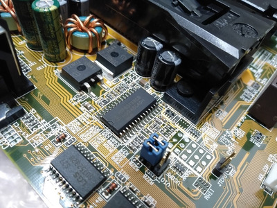

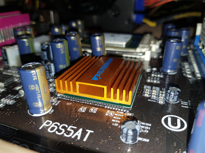

Looked out for a single 2-inch high bronze heatsink, but was coward into settling with ones for GPU .
Installed two of these cuties on P2B HIP6019BCB.
I'll check how hot this and other MOSFETs get as my P3S runs in full throttle.
I'll prolly end up installing heatsinks all over the places.
Btw, it always is quite a thrill to watch contemporary meets classic before your eyes.

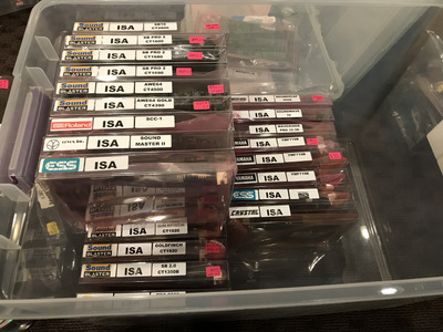

Been a couple of years since I printed off some labels for organizing my loose card collection. Most cards fit in a standard Atari 2600-size clear box protector (some need a slightly-longer Intellivision-size). All cards in anti-static bags. Got about three bins full of loose video and sound cards. Very handy for grabbing the card you need.
