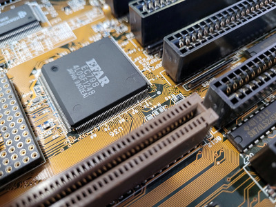

I'm troubleshooting an AOpen Vi9 motherboard that is kind of curious and important to me because it's a 386/486 combo board with VLB. It doesn't POST though. There is some battery damage I am fixing up, but I also noticed this strange solderjob on the chipset legs, it's as if two legs are soledered to a joint solderpad that go to the same via. Anyone think this is leftover from a botched repair attempt (and possibly root of the problem) or just something normal? Maybe they are both ground or something? I am not familiar with the chipset in question but the markings say it is an EFAR EC798.

I can't find a datasheet for it, but it looks ok to me. The PCB trace looks to head for both of the pads, so must be meant to connect to both pins. It's also looks slightly thicker than the nearby traces so might be a ground or power connection, or a configuration pin.
OTOH, a thread here https://www.vcfed.org/forum/forum/genres/late … v3486ef-386-486 has a photo of the same chipset with those two pins with separate traces.
Looks like the legs share a soldering surface and a route, so it's probably not a defect.
