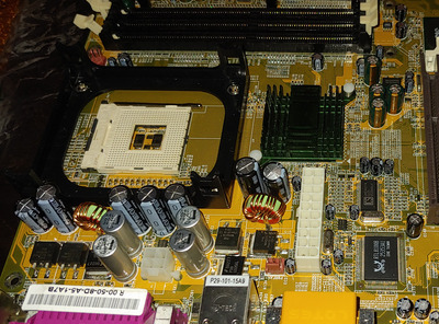

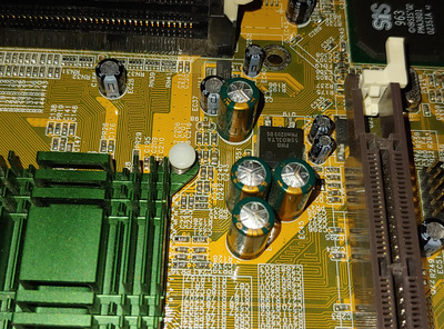

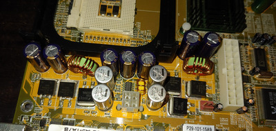

Partially recapped the Abit SR7-8X board some hours ago. The soldering iron I use had to be set to near max to remove and replace the caps (no surprise). But, I can't test the board. I misplaced the older Pentium 4 CPU cooler somewhere in my room. Before and after images provided.
Before:

After:

It's very hard to replace capacitors on some PCBs due to the copper ground plane acting as an enormous heatsink. I use a very wide solder tip in this case to heat up the area surrounding the via to try and counteract this. You don't want to direct all of the heat into the pad or you're at risk of delaminating it from the board.
It gets even worse when ROHS solder is involved. I've lost hours due to solder refusing to melt or getting stuck inside a via that blocks the insertion of new components.
A pre-heater can help and I've been wanting to get one but they are large and expensive and I don't think I'd use it often enough to justify the expense.
